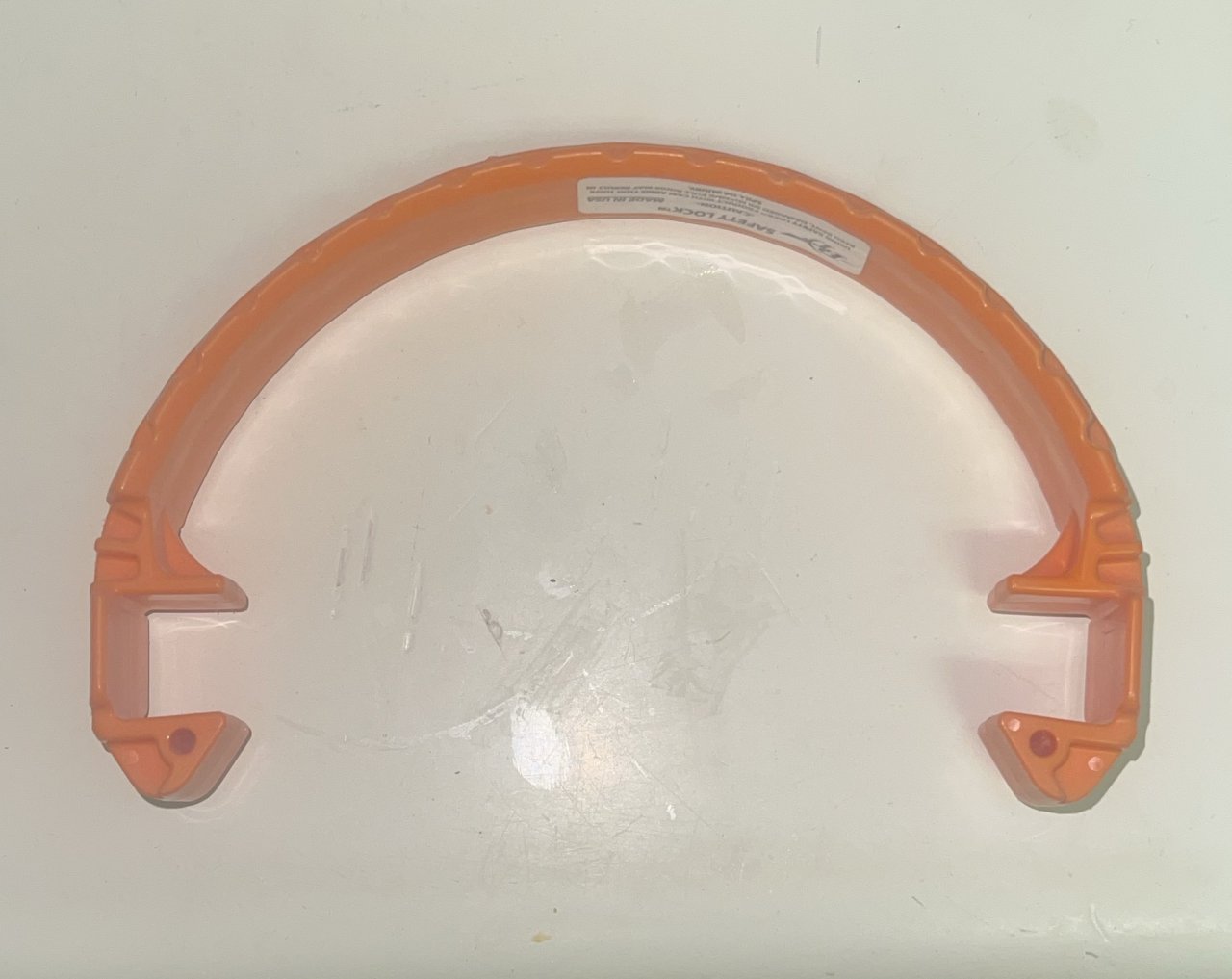

    I buy my own cam locks. For some reason none of the companies I’ve worked with ever supplied them. Better safe than sorry. IMG_8781.jpeg

    Not the Velcro strap?
