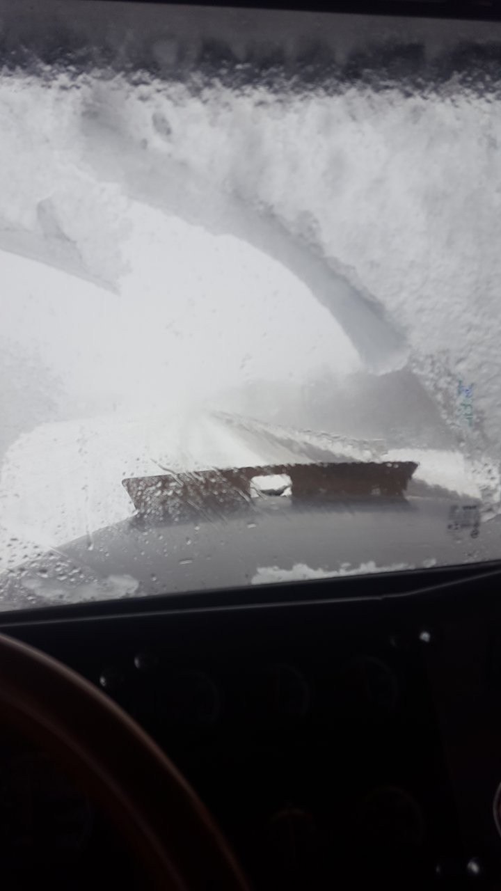

    Total respect for your opinions but for my truck, I have to keep my defrost on high or my windshield will ice up on me..
