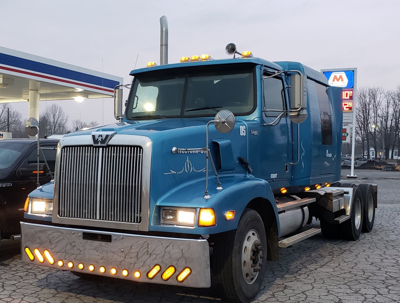

    I'm trying to figure out if a 2001, 4900E mid roof sleeper (TOP pic)
    Will fit on my 2000, 5964 with flat top? (BOTTOM pic)
    Would it be the same bolt pattern? and would they marry up with no issues.
    [​IMG] 20190206_121846.jpg Any help would be appreciated.
    Thanks
    RIBS

    Is that pic of the 4900 the one it is coming off? What are you doing with the cab?

    Yes i was lucky enough to get a photo of the truck before they tore it apart.
    The Flat top im using what parts i can and the rest ill sell i guess.

    That 4900 a extended hood ?
