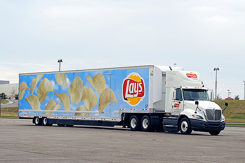

    KY trailer will be the best bet . Look for a old moving company trailer.
    Frito-Lays uses KY trailers too .

    And FYI, those old Frito Lay trailers are nice, they never carry any heavy weight, never have a forklift in them and are well taken care of.
