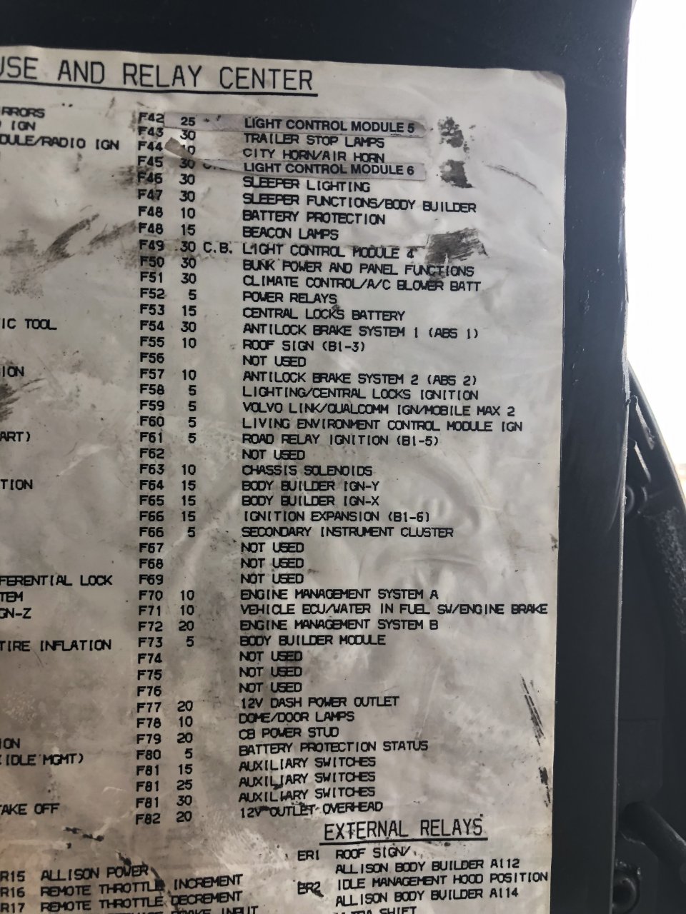

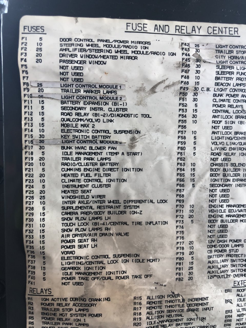

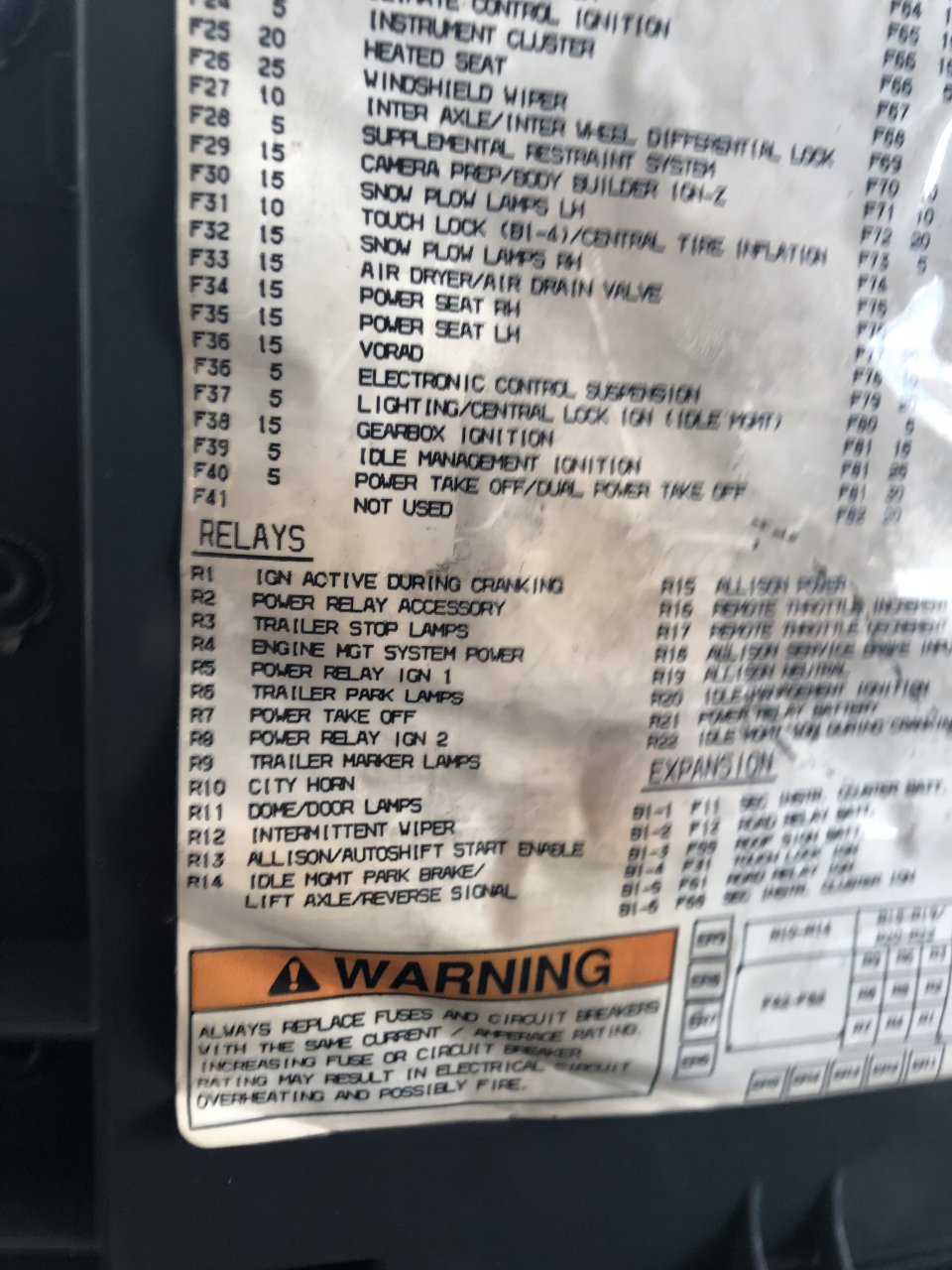

    2006 Volvo 670. Where is the fuse located for 5th wheel air bags and diff lock. None of them are working. And it’s not labeled on panel

    F16 is diff lock fuse
    F23 is air suspension
    F01-F40 fuses are in the front facing fuse panel F40 and up are in top fuse panel.
    as far as the web reckons
