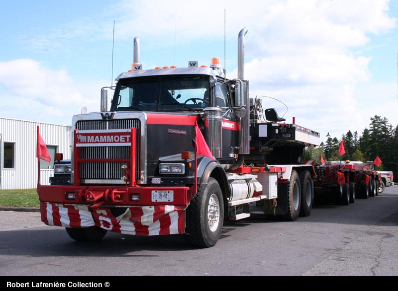

    There is a reason you only see KW's pulling super heavy equipment. I forget what the truck is called in Tx but it's a kw that pulls a lot of the huge stuff around there.
    Rollr4872 and lynchy Thank this.
  4. GeorgeB
    GeorgeB Light Load Member
    90
    8
    Feb 20, 2012
    Denver CO
    This look like T800, and a set up for super load, I wont go that big due to lack of experience and bunch of other things...

    You only see KW’s pulling heavy? Wow. The truck in your video is Bay they’re based in NYC.
