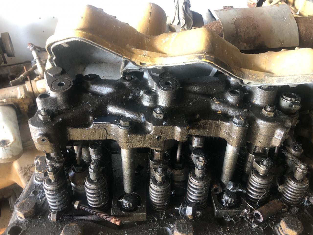

    Hey guys if this is in the wrong spot tell me and I’ll move it. I found a set of jakes for my mechanical 3406c. Problem is the model tag is worn off. Anyone care to take a stab a what model they are. Thanks. Btw I’m looking for a set of 346d or 349a if anyone has a complete set to sell. Thanks.
  3. Gambino1994
    Gambino1994 Light Load Member
    187
    102
    Jan 22, 2009
    causing a situation
    I have 346d on my 3406c and that picture doesn’t look like mine. Alledgely you will not find a 349a they’re too rare but I’d like to find a set too

    Is there a “front>>>” and “<<<rear” cast into them? My 346’s have that, maybe those are a pacbrake of somekind. Seems there’s guys who had bad luck with 349’s and some who get a million miles out of them. The 349 need some kind of special tool to adjust them but they’re supposed to have more braking power. My 346’s on my 3406c are roughly 1/2 to 2/3 as strong as the 340 on my 3406e I had

    Ya the old boy has all the tools. Ya it’s a gamble on how they will work. I also have a brake saver so it’ll be deadly to have both. Iv been trying to look at castings online to see if the 349 is different cause it must be. But if these are the b or c jake in 346 I don’t want em.

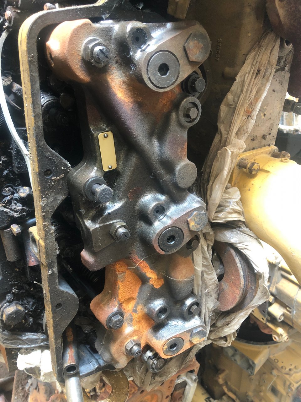

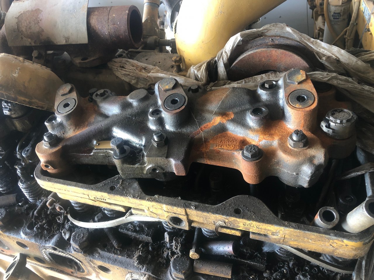

    Some other angles of them.
  10. Inderjit
    Inderjit Heavy Load Member
    716
    703
    Sep 17, 2017
    The yellow and blue plates would have had the model number on them. Carefully clean them and you might be able to see what they are.
  11. Inderjit
    716
    703
    Sep 17, 2017
    Looking at your pictures I'm pretty sure those are 349 Jake brakes.
