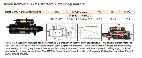

    Looking at Starter specs - it says the Delco Remy 42MT (a large starter) is designed for a maximum (or nominal?) of 1650 amps.
    So if the batteries and cables are good, and the engine is okay, I should never see more than 1650 amps cranking.
    If that is correct, than a 1,700 Amp Jump Start unit should be enough for a boost. If it is not enough, then I have another problem. Something like this https://www.walmart.com/ip/JUMP-N-C...MIjMyR2Oa85gIVvoVaBR3TLApqEAQYBCABEgJWYvD_BwE
    [​IMG]Delco Remy 42MT - rated Starting Amps

    Stone dead batteries at below freezing temperatures I doubt it'll start it.
    The clamps on the cable leads have a small fraction of the contact area a battery cable has on the battery's post. You lose a fair amount of potential right there with just a poor connection to the battery terminals.
