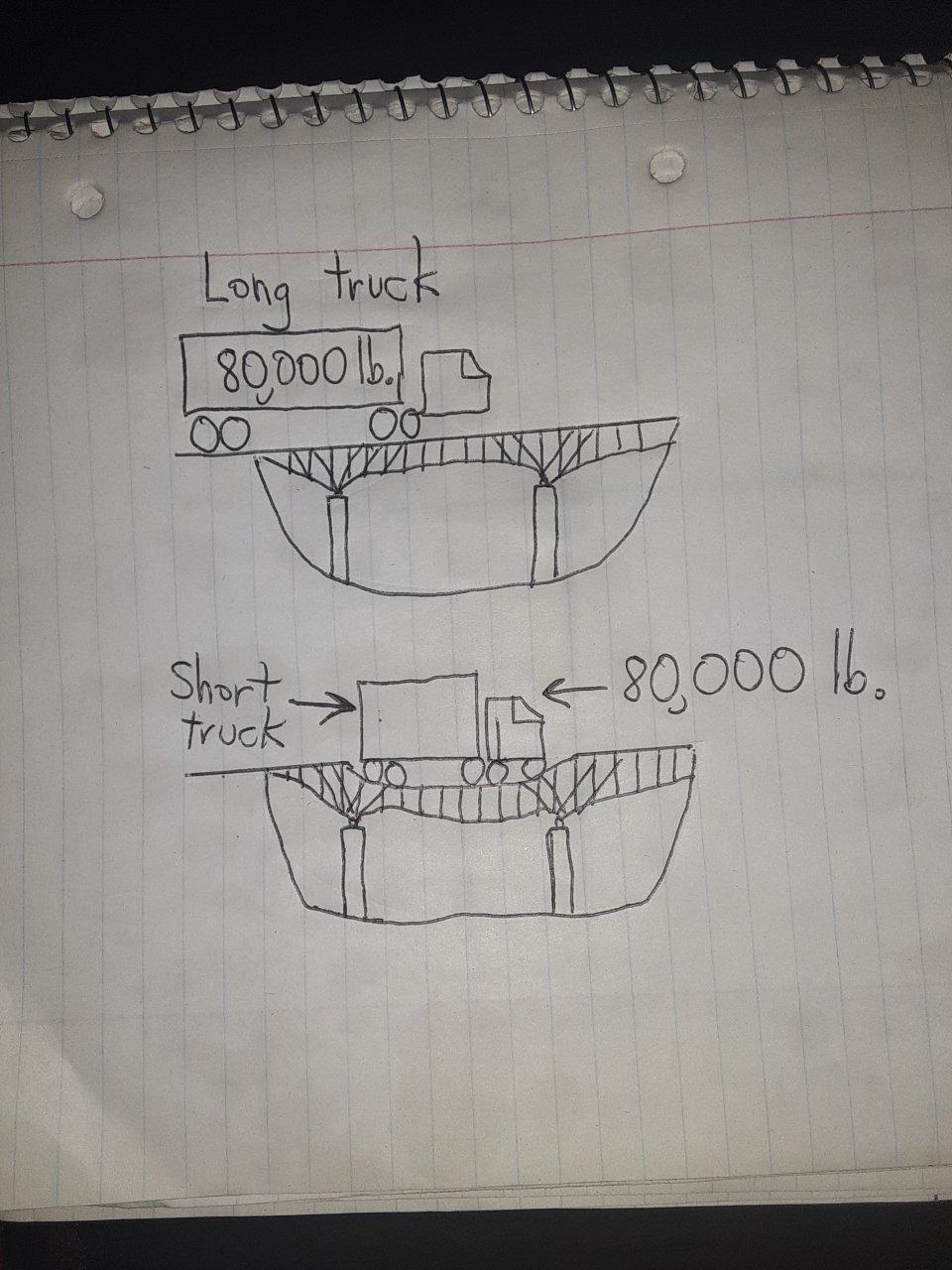

    I used to work for a trucking company that had a diagram showing two different trucks on bridges to show how tandem placement can affect the weight distribution on bridges. The diagram looked something like the drawing in the photograph below:
    Now I totally understand why a short 80,000 pound tractor-trailer would strain a bridge more than a long 80,000 pound tractor-trailer like in the drawing in the photograph above. In other words, I understand why if there are two tractor-trailers of the same weight, the tractor-trailer with the shorter wheelbase will strain the bridge more than the tractor-trailer with the longer wheelbase.
    Here's the part that totally baffles me: Why do the bridge laws force drivers to keep a shorter wheelbase?
    Since the tractor-trailer with the longer wheelbase strains a bridge more than a tractor-trailer with a shorter wheelbase if the two tractor-trailers are of equal total weight, I would have expected the bridge laws to force truckers to slide the tandems to the rear. I would have expected the purpose of the bridge laws to prevent truckers from having too short a wheelbase. Instead, the bridge laws prevent truckers from having too long of a wheelbase.
    California has the strictest bridge law of all, requiring the distance from the kingpin to a point on the rear axle to be 40 feet OR LESS.
    Since a shorter wheelbase puts more of a strain on a bridge than a longer wheelbase for a given weight, why is the purpose of the bridge laws to prevent the wheelbase from being too long (instead of too short)?

    Well, I suppose they don't DIRECTLY force anyone to have a shorter distance between their drives and their tandems. The bridge law force trucks to have a shorter distance between the kingpin and a point on the REAR AXLE ASSEMBLY. So, in practice, it does force people to have a shorter distance between their drives and their tandems.
    "We've got to slide the tandems forward. We're going to California."
    I've worked in the industry for over 8 years, starting in 2012. I've drove for three trucking companies. EVERYONE at every trucking company I ever worked for and everyone at the truck driving school I attended referred to the laws dictating the maximum distance between the kingpin and the rear axle assembly as bridge laws.

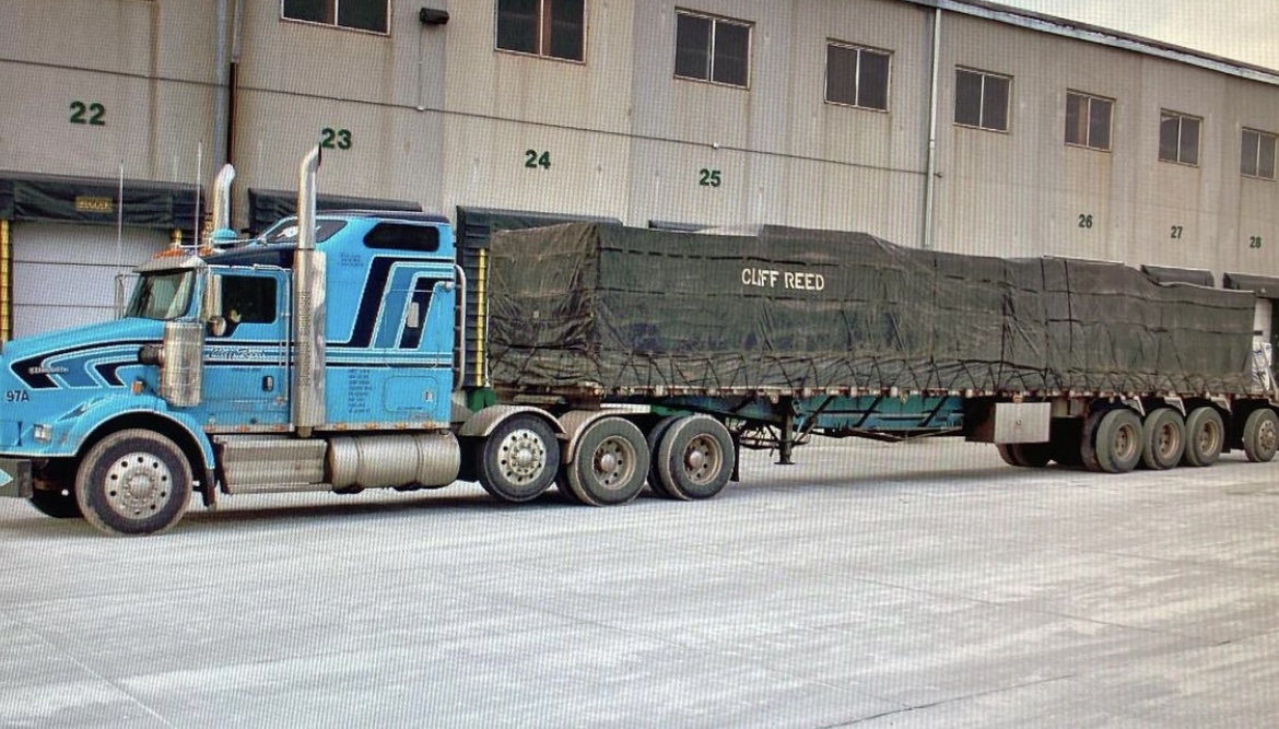

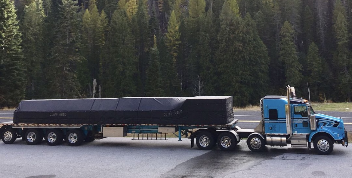

    Here’s an example of the bridge formula at work. These two trucks that I drove couldn’t gross the same amount of weight, despite being very similar. If you can tell me which one could gross more weight and why then I’ll know you have a grasp on bridge laws and that you’re not confusing bridge laws with KPRA regulations.
    FA557BC3-57A1-4177-8039-3D510FF1AB09.jpeg 4C6C8925-E348-4B58-9936-D259326B0ABB.jpeg

    No, you've got it backwards. If you want to be heavy, you need more distance, not less.
    KPRA is length only. Bridge law is weight in a given length.
