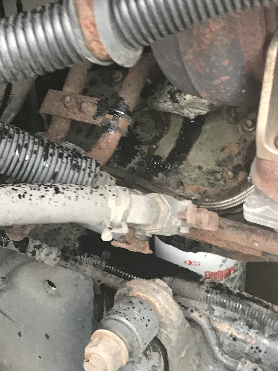

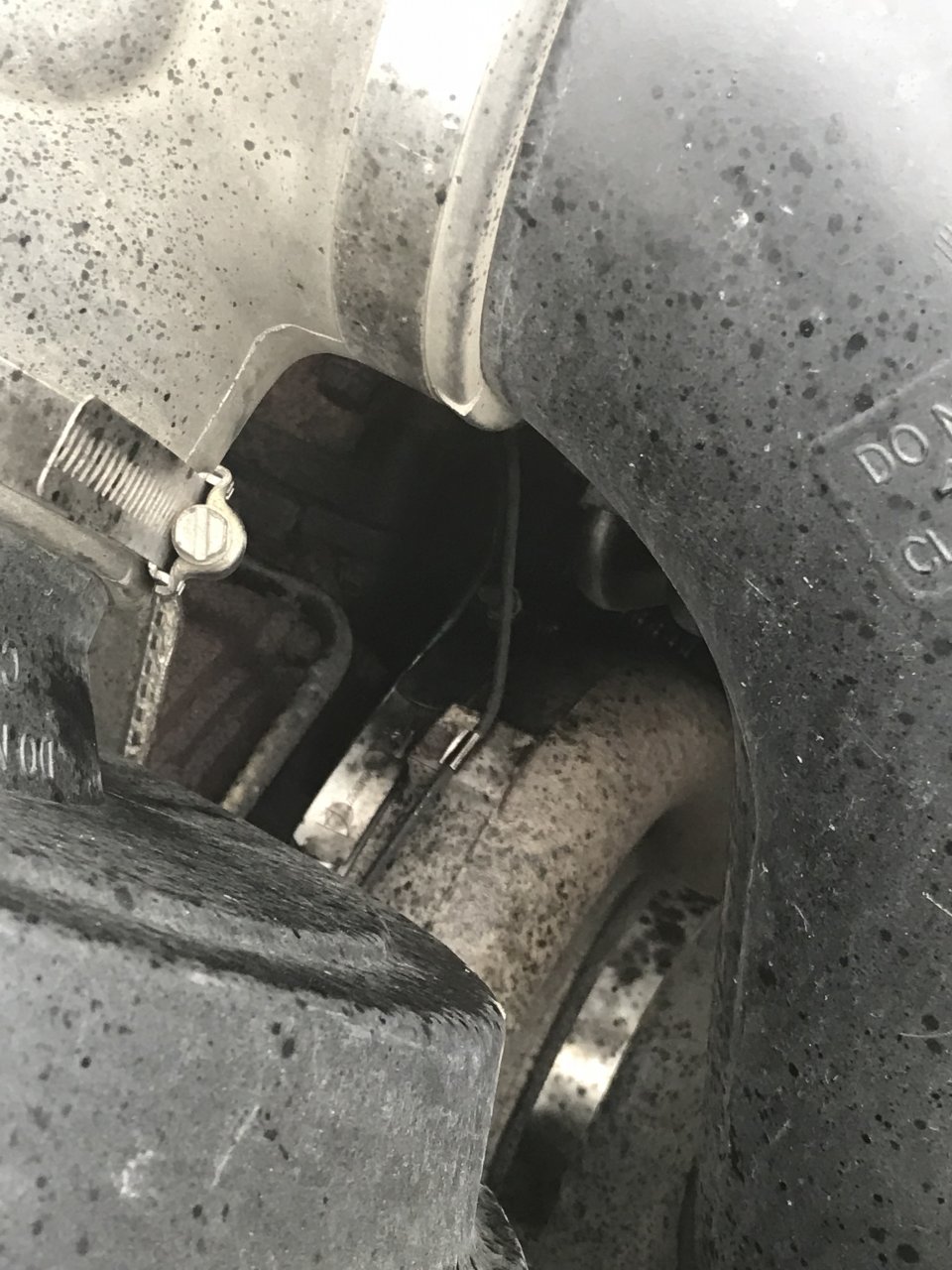

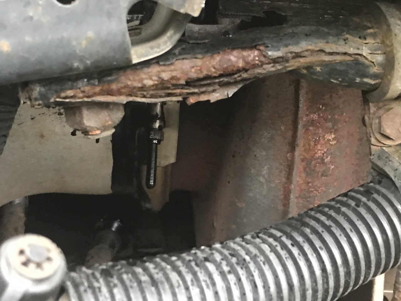

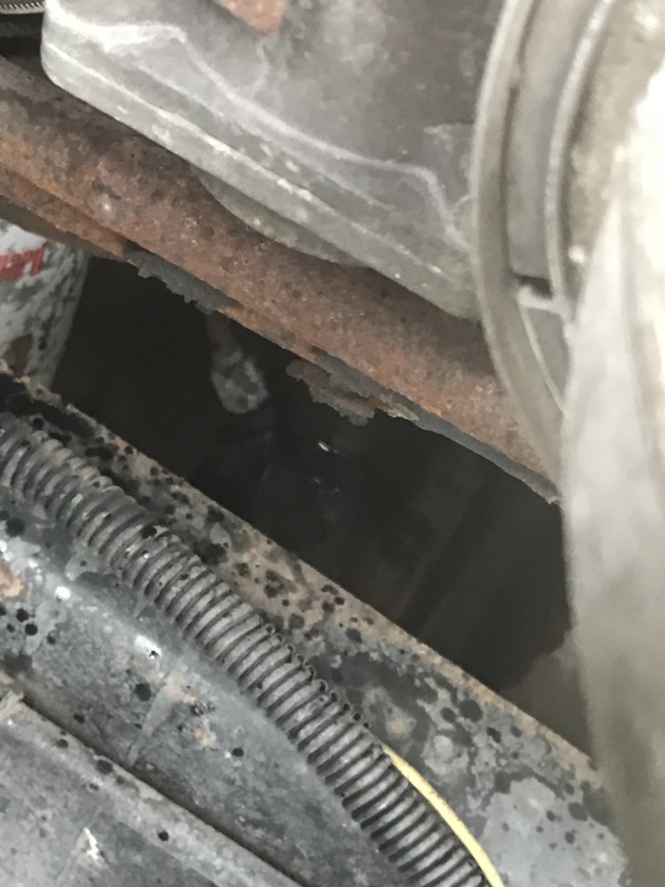

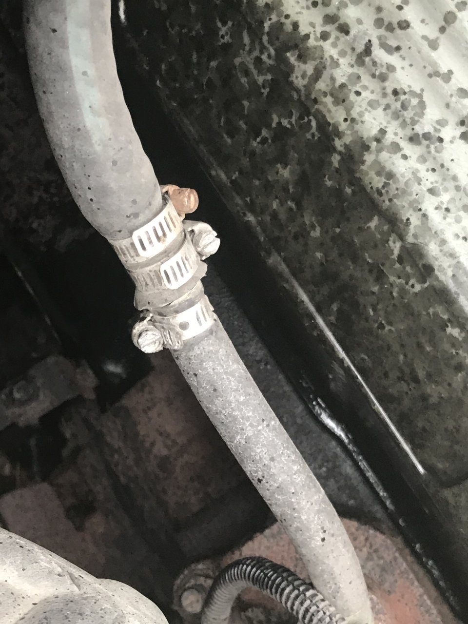

    Recently blew my turbo.....I think it was just a fluke maybe. I started up a hill and it was pulling fine, went to pass another truck and heard a slight boom, It wasn't as big as I thought it'd be. From the time it blew to this time I turned it off(thankfully there was an exit ramp right there) was probably 30 seconds. There was 1 blume of smoke and no oil coming out of exhaust. There was a lot of smoke in my truck coming from the passenger side though.
    I use the term "blew" loosely as it didn't come apart and shatter into pieces. There was just oil near the rear clamp on the exhaust pipe coming out the back of the turbo.
    So what makes a turbo blow? This turbo was installed with 594k miles on it. I now have 1,037,000 miles.
    Weird thing is on Monday afternoon while driving, I got a code for the turbo boost sensor. And it did seem to boost/decrease boost/boost just at random times. I carry extra sensors in the truck so I changed it the next day. I didn't drive again until Thursday afternoon. It rode fine. Then Friday morning 2 hours after started driving it went haywire.
    I NEVER idle, I am heavy a lot of times. Heavy to me is grossing 70k+. Ive been over 105k a few times this year.... I know that low oil pressure can cause one to blow...what other things can cause this? Can a hole in the air to air cause it? Just normal turbo failure?... Ill post pictures in a few...
