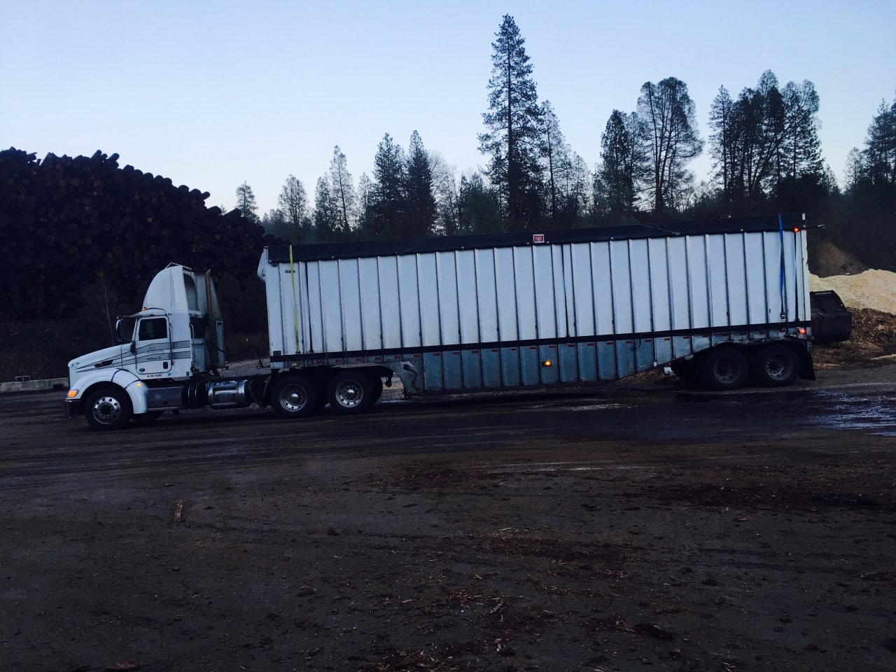

    IMG_4700.jpeg 42 ft possum belly. With white fur that’s green and heavy, can easily haul 30 tons or more. Could box it out and be around 100,000 lbs.
    Deere hunter and Arky Thank this.
