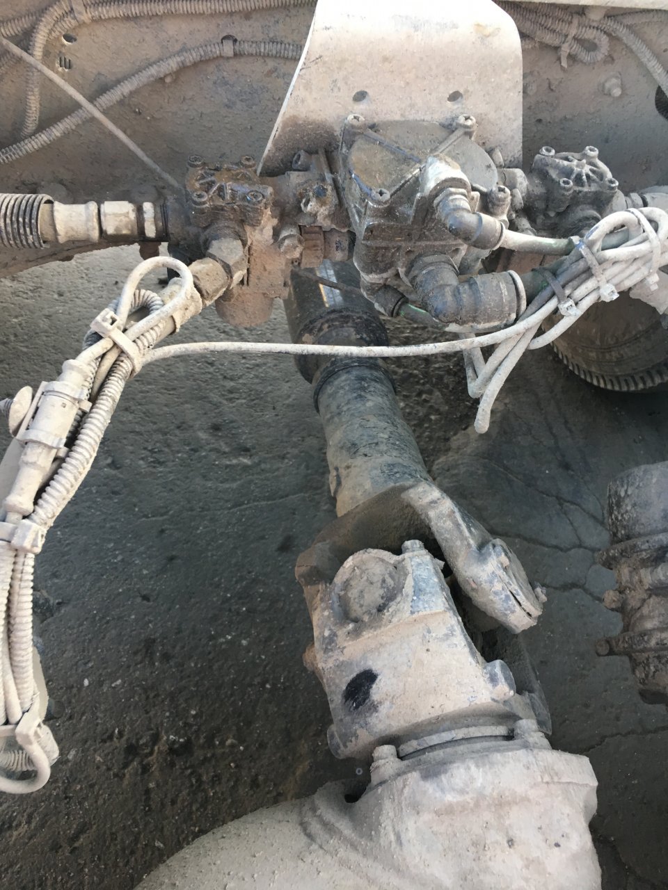

    i have a wabco abs air valve (see pic attached) that is leaking from the bottom runber exhaust port only when the service brake is applied. It does not leak when the service brake is not applied. Having the parking brake applied or not applied does not change anything.
    This truck has 2 abs air valves one controls the driverside rear axle and the other controls the passenger side rear axle. The problem is with the passengerside rear axle abs valve. Thanks in advance.

    If air is leaking from the exhaust port with service brake applied, the valve it bad. Air should only exhaust from the valve during an abs event or during the chuff test at key on and brake applied.

    Are you talking about the modulator valve, the small ones on the the side of the relay valve? If it's leaking out the exhaust port only on service application, the valve is usually bad. But, sometimes they get dirt in there and chuffing them can blow it out. With full air pressure, shut the truck off, hold your foot on the service brakes and turn the key on. When the ABS goes through its modulator click test, you'll hear them chuff with the service pressure on them. If it's dirty, this can blow the dirt out. Worth a shot before you replace it.

    Correct the modulator valve on the side of the relay valve (the one that controls passenger side brakes). I will perform the chuff test today and try to clear any debri and post back with results. If it still leaks i will replace.

    I personally wouldn't mess with it. If it still leaks after a chuff test with full air pressure brake applied surely the seat is damaged and not repairable. I doubt you'll find service parts anyhow, too much liability given that it's a safety device.

    Thanks for the tip of "chuff test" didnt work this time but good to know for other truckers to try. I will be Changing out the modulator this weekend, keep you posted whether or not it fixed.

    Changed out the Modulator for a new one and no more leaks!
