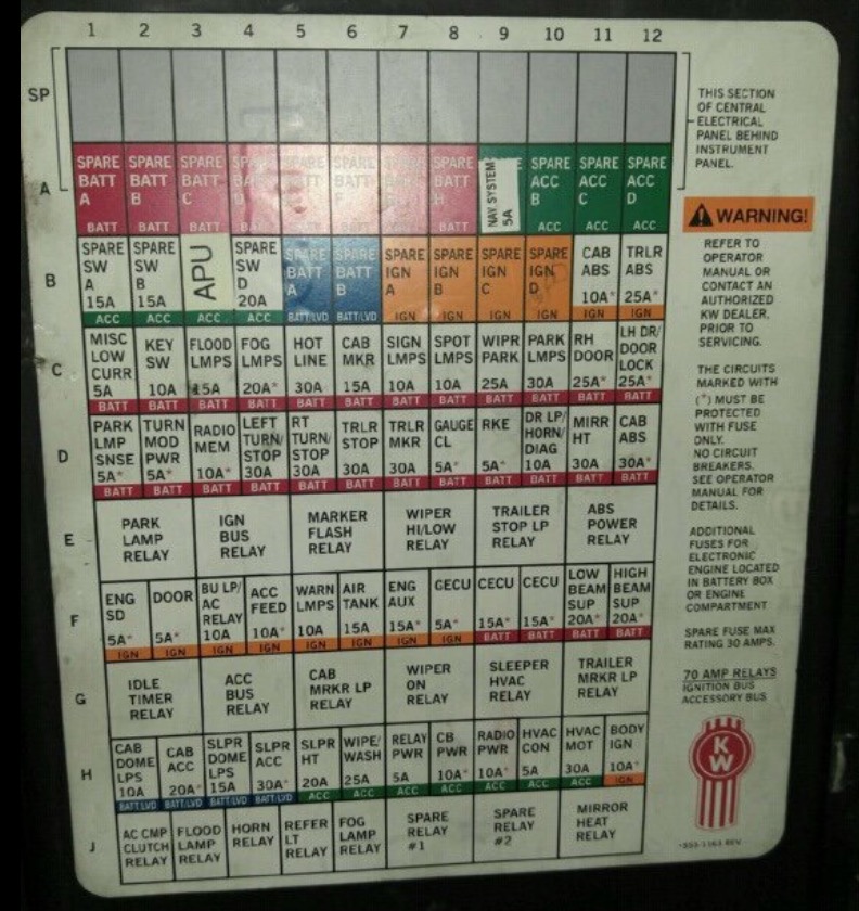

  10. Lysdexis
    Lysdexis Road Train Member
    4,483
    47,940
    Oct 25, 2018
    Is G 7/8 the intermittent relay?
    I have an issue with wipers not returning to park. Low and high work fine but it stops anywhere I turn the switch off, no matter what speed I had it on. Intermittent wil go up and stop all the way up and then eventually it will come back down and stop, then it will go back up and stop. It repeats this until it's turned off.
    Edit: can't return to park if the park fuse is bad.
  11. kwcam
    kwcam Light Load Member
    193
    145
    Dec 29, 2012
    at the shop
    If the wipers don't park check the fuse at C9, if the fuse is good then the wiper motor has a contact switch inside that failed, will need a new wiper motor.
    The G7 relay is the on/off .
    Lysdexis Thanks this.
