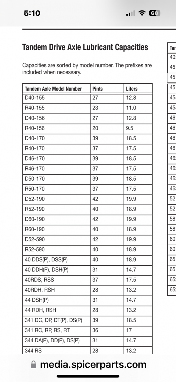

    Ive looked all over and cant find anything. I changed my rear diff fluid today and it took about 3-3.5 gallons.
    I cant find anything on the front and rear capacities online? I didnt do the front yet as im headed to the dealer tomorrow morning to get a carrier bearing and im gonna ask them.
    Truck is a 2016 w900 glider....but, KW done everything on it except the engine.
    Anyone know the how much fluid each should hold?

    as much as it takes to start running out the fill hole. the front will be closer to 5 gallons

    Yeah thats the way I did it. Im gonna do the front this afternoon. The rear started running out after about 3 gallons.
