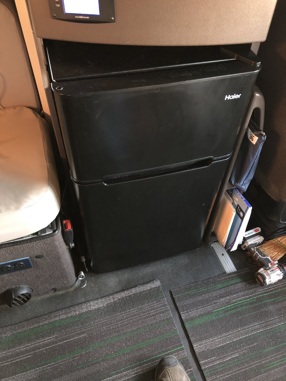

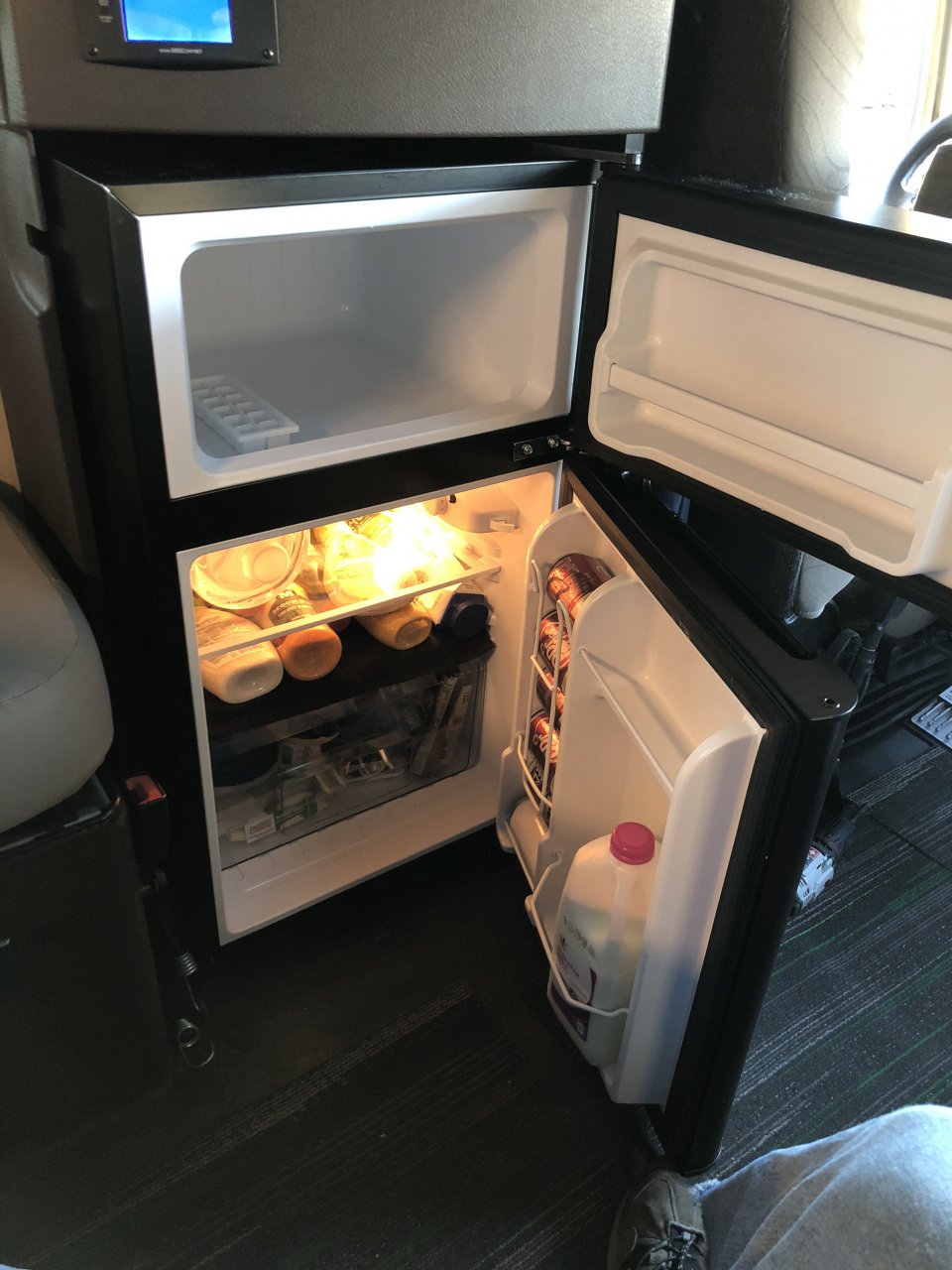

  10. 86scotty
    86scotty Road Train Member
    4,373
    11,589
    Aug 27, 2017
    Appalachia
    PE_T and express19 Thank this.
