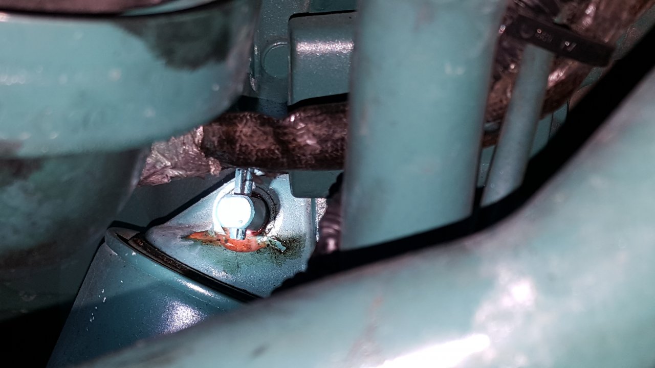

    I noticed this small leak around coolant shut off valve, the filter has been replaced 2 months ago. I'm just wondering if this valve position is ON, so the coolant goes through filter or was forgotten in OFF position after filter replacement ?:eek:
    Would the cooling system work with this valve closed? I found mixed info informations , some are saying is closed at "11 o'clock"?
    Any tips, plz ?

    That's the same position as mine so it should be open.

    Yes the cooling system still works just fine valve is only there to close filter for ease of replacement problem is that it’s completely useless as soon as you try to close them they leak and they are usually rusted in one position. So they closed it and hence the leak

    So is it closed or open in my photos?
    If it's closed the coolant doesn't get filtered, right?

    Yes this is the only side effect but think about it for a min if you take care of the truck like one is supposed to coolant just changed from hot to cold and it should not carry any debris that would need to be filtered

    Straight up = Open
    Sideways = Closed
