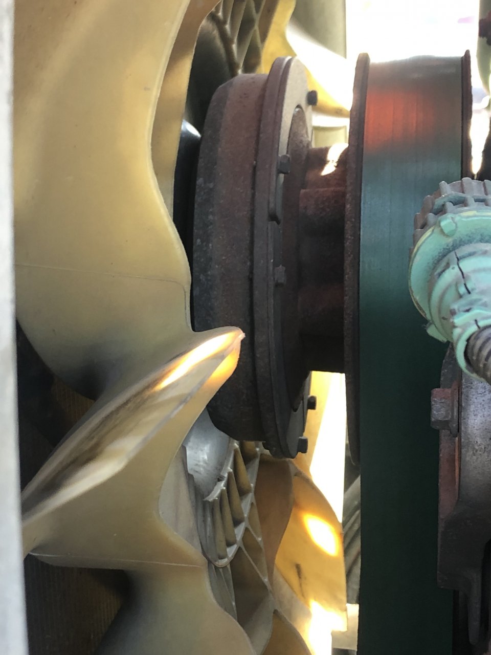

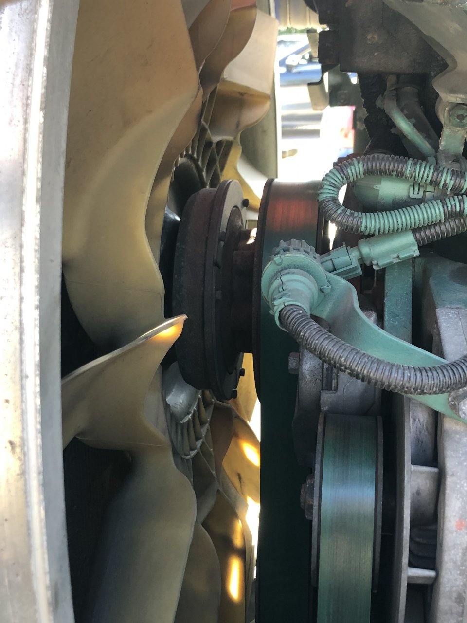

    2012 Volvo d13. My fan stays running all the time. I can stop it with my hand and spin it backwards while running. My ac doesn’t work ive replaced the fan solenoid and tapped the clutch with a hammer doesn’t seem to ever stop. I’ve checked all the fuses. Do you guys think it’s time to replace the fun clutch? My truck over heated 1 time last week and hasn’t happened again. Any other suggestions. Anyone know the exact fan clutch i need?

    Had same problem, same year and model. Yep time for a new fan clutch hub.

    Your fan is electrical variable speed. It should spin free if not engaged. Check fuses and wires.

    1st disconnect the air line to the fan hub. Start the truck the fan should run like hell. You just bypassed everything. If it's not the hub is bad..
