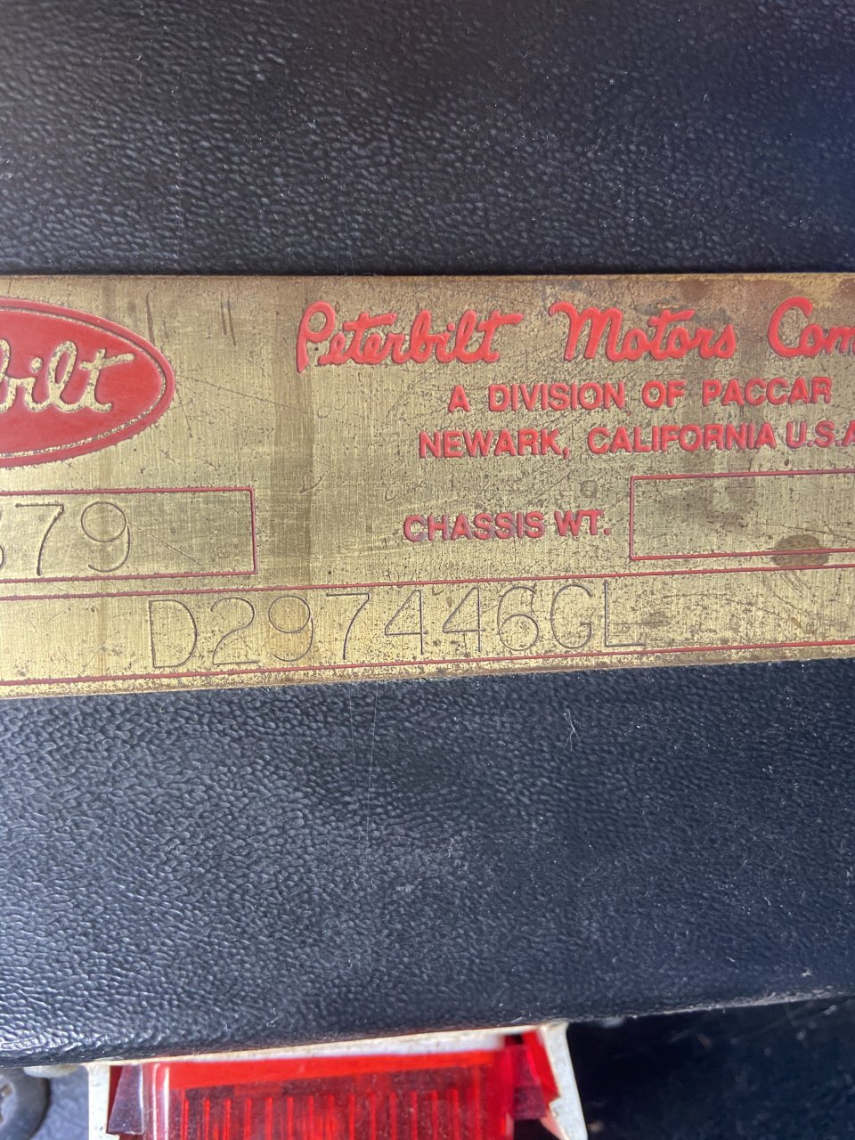

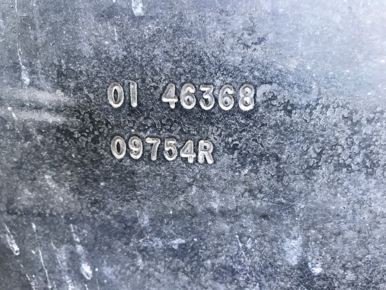

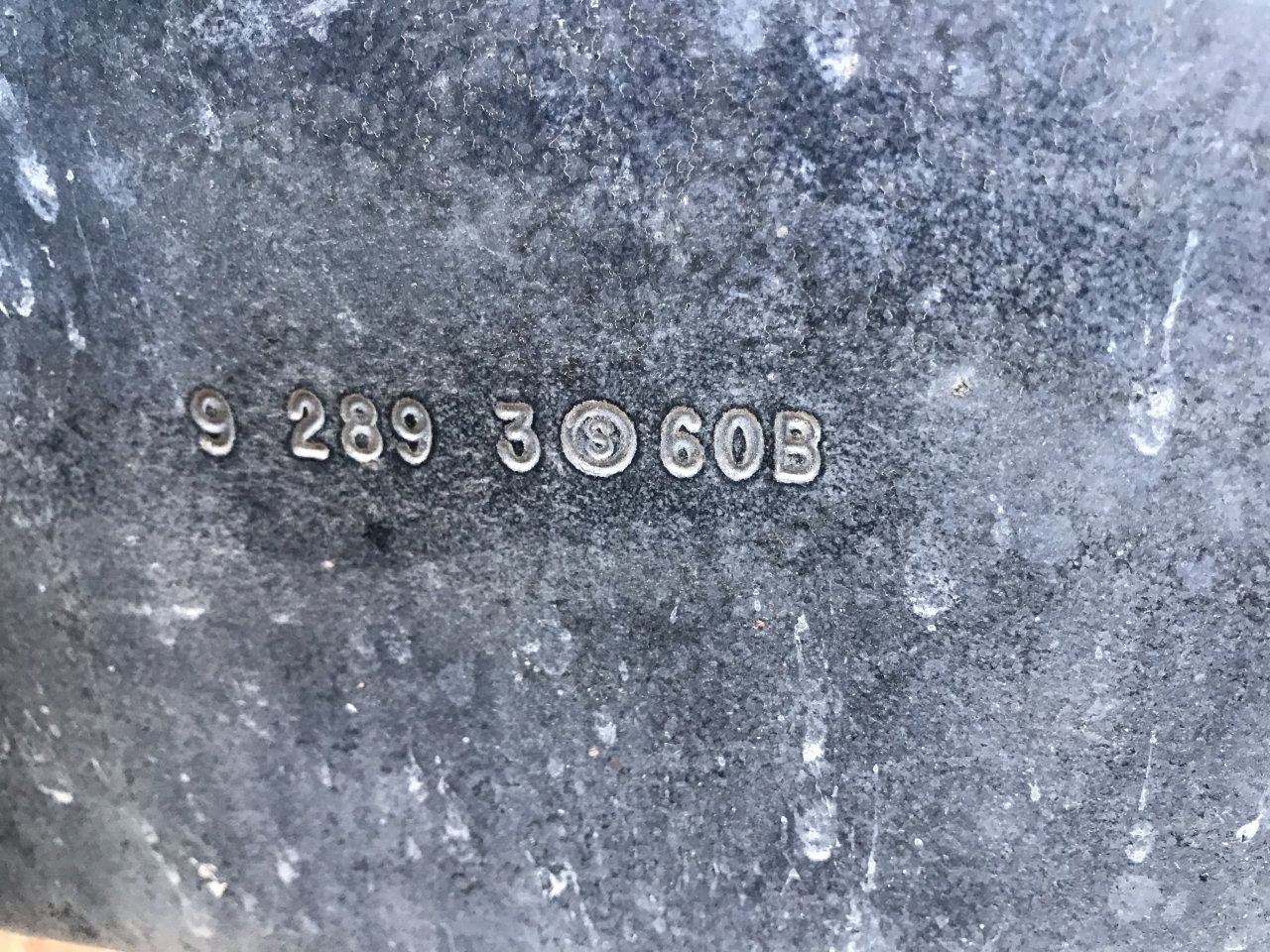

    Alright guys I need some help. I can’t find the 17 digit vin on a 1990 pete I just picked up. There is a peterbilt plate under the dash on the left side of the steering wheel ( like there should be) but it has a 9 digit number stamped on it. I gave this number to my insurance agent and she said it wasnt a valid vin. Must be a 17 digit number even on a 1990. So I called he local Rush Center and they weren’t any help. Told me to check the frame near the cab (checked, not there either) or look for the sticker inside the door (well not ####, not there either). Any thoughts would be greatly appreciated.

  4. Redtop JNE
    Redtop JNE Bobtail Member
    7
    3
    Apr 13, 2020
    That’s what Rush suggested and there are 3 different sets of numbers stamped on both sides of the frame near the stear axle but not a full vin or anything that adds up to 17 digits. Thanks for the reply.

  8. AModelCat
    28,842
    154,214
    Anything on the top of the frame rail flange?

  11. spsauerland
    spsauerland Road Train Member
    4,296
    10,886
    May 31, 2010
    West Harrison, In
    It's a glider. Insurance company told me same thing on my 82 Glider. Wikipedia helped me figure out the corresponding 17 digit VIN.
