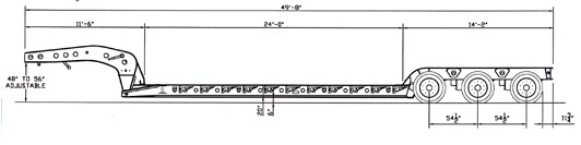

    This is close to what I'm thinking but with more ground clearance. I don't necessarily need 1' but I don't want to scrape on land when going over a hill.

  11. 543876
    543876 Bobtail Member
    29
    5
    Mar 1, 2015
    The trailer in the diagram is a "Removeable Goosneck Trailer" The goose neck detaches from the rest of trailer to alow driveing equipment up onto trailer. Im not sure if you are aware of that. Its different from a low boy which is all one peice. Three axels are for hauling alot of wieght, think over 80K lbs truck trailer and load. I pull a step deck, it weighs 12k lbs. I cant imagine why you would want to make an RV out of something so heavy.
