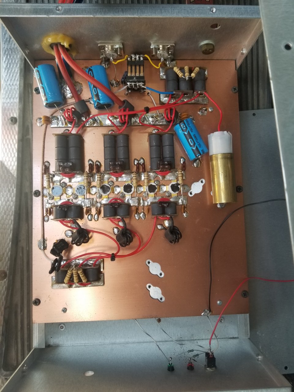

    I decided to open it up just to see what's in it. Here's what I found. 20180509_181051.jpg
    I'm told it's a 6-pill. Not sure what I'm really looking at here lol. I guess if it said CAT or Cummins or had gears in it somewhere I might figuerd it out a,little easier.
    Thoughts ?

    Note the 6 round transistors between the chokes. Black globs on the white ceramic circles.
    rabbiporkchop and snowman_w900 Thank this.

    I see that. I kinda figured that's what They refer to as "6-pill".
    So, what's the difference in a straight versus a 2x4 or other configurations?

    6 pill is just that...a straight- 6 pill box, meaning if you had a regular 4w cb radio, the amp would really need a driver. (1 pill driver) to get the most watts out of it, or a big radio like what you have...
    2x6 is a amp with a 2-pill driver...
    snowman_w900 Thanks this.

    Wow I would think .... never mind, any maker blotting out device numbers is one to stay away from - professional opinion.

    The builder of that amp passed away, Stickman. He made some good boxes. That Connex will do very well with it pushing about 150 Watts. I would run no less than 4 gauge if it’s a short run or as big as 00 gauge to the batteries. Ground the batteries to the frame with some copper flat braid, good coax and a good antenna like a Predator 10k. That box will probably push 12-1400 Watts and get you through the clutter.
    Since the transistors are colored over it’s a little hard to tell if it’s Toshiba 2879s or not. You will be happy with it once you run it and you keep getting your named called in DX land.
