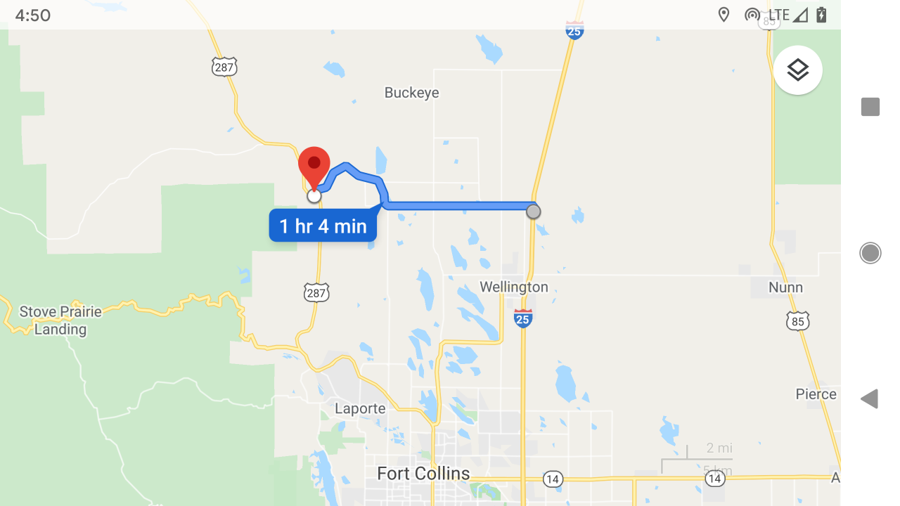

    Screenshot_20200715-165038.png If your feeling adventurous and want to try a dirt road "shortcut" you can run up to exit 281 and take Owl Canyon Road over to 287. It isn't too bad, but is a good alt route when there is construction going on in FtCollins.
    Not sure what is going on with Google, it doesn't take an hour+ to drive 12 miles on a dirt road... Not that one anyway. :)

    I take owl canyon every day. It’s routed in our company’s miles. Dirt road is only like 5-10 mins of driving on it. Way better then Foco unless your going through Foco in the middle of the night. DOT does post up on owl canyon with portables during the day sometimes.
