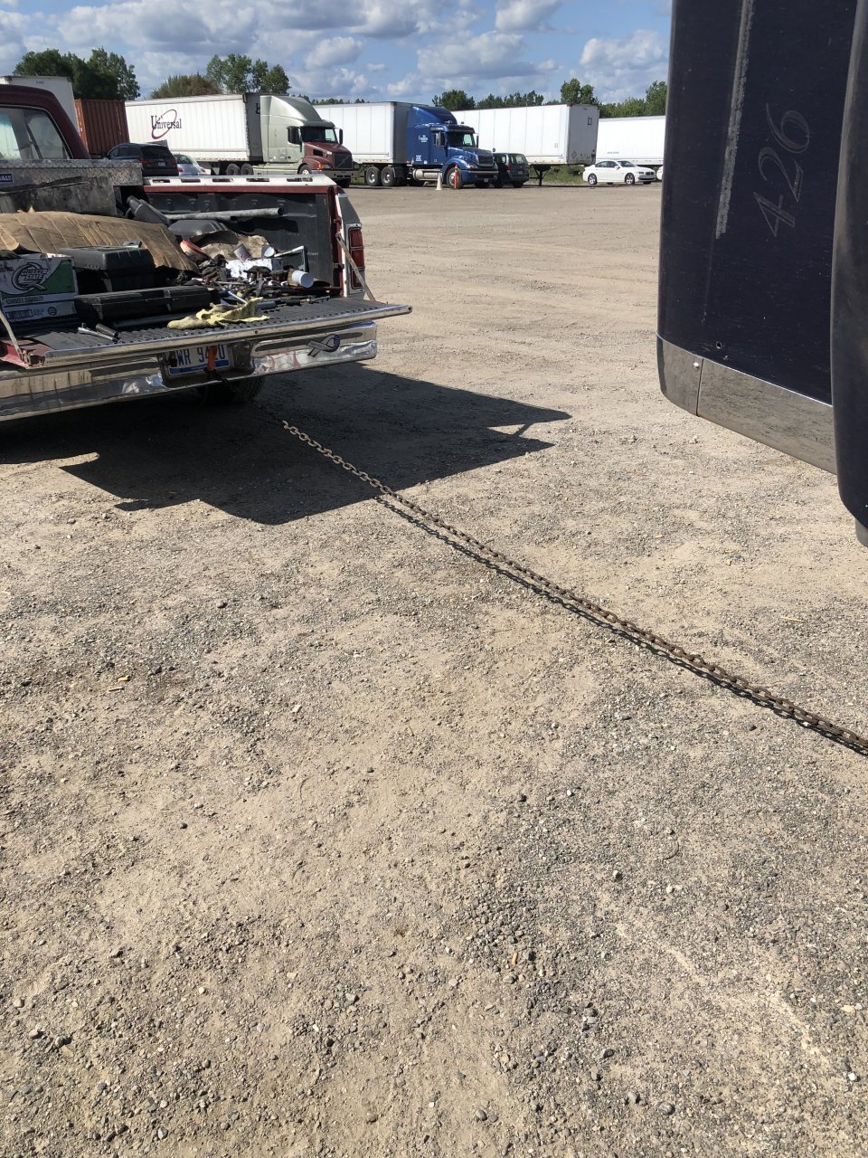

    Clutch and install kit, about $1000. Also did rear main, re sealed rear structure, new flywheel, motor mounts,oil pan gasket, and used one piece reamless cross shaft bushings, along with new shafts. I had a lot of play before. Now none, The fork fits much better on the new clutch. Old one was real sloppy. It was a huge very intimidating job for Me, one I never want to do again!! Installing clutch itself is the easy part. It’s all the other things involved. Simple Instructions in box, Eaton videos, and Detroit manual. And especially a whole lot of help from @BoxCarKidd, Thankfully, He was amazing, Got Me through quite a few jams.A wealth of knowledge. I tried to do everything by the book. Except installed the clutch on trans first. Torqued through acess hole. Glad I took that advice. Did the job on gravel. 2 pc 1/2” plywoood, with a piece of sheet metal on top. Had wife in the pick up on speaker phone. Lol. Surprisingly It worked great. Lined up almost perfectly, Only had to adjust it clockwise about 1/2”inch or so to line up bolts.
