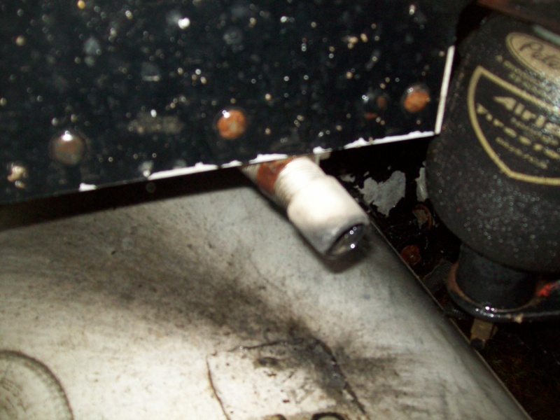

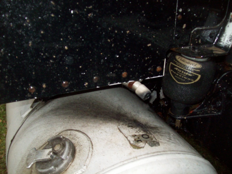

    Here's a few pix that may help you.... the only thing i would change would be mounting the heat duct a little higher... you can adjust that 'eyeball' vent but it would help warm the bunk area a little faster if it were a little higher IMHO.
    I haven't used my cab heat yet... the ESPAR keeps my feet toasty warm and it CAN be used to heat the entire cab/bunk. My bunk heat hasn't been connected in over 5 years because i can't see paying $400.00 for a heater core from Pete...
    I would also insulate the mattress by placing a 1" or 2" Styrofoam sheet under the mattress... it makes a world of difference in all seasons.

    thanks everyone for the replies, and thanks for the pics Krooser, I'm concerned about the so called air short circuit, by having the vents too close, am wondering about running the fresh air tube all the way around the under bunk storage compartment and into the cab from near the ac unit.

    Never heard that term 'air short circuit'... I can't imagine there being any problems with the way mine was installed. If you are concerned about 'make up air' for the combustion process just crack open a window a bit... my old Pete is not air tight by any means so I've never had a problem.
    My local Thermo-King dealer did the install... the company I was leased to at the time had about 40 trucks equipped with these and there were zero problems.
