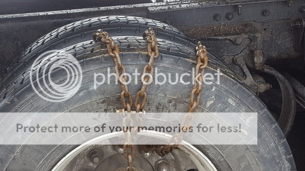

    Tonights temps are 31 degrees. The field will be thawed out today. I don't have any claws to use yet so i'm going to try out wrapping my 2 towing chains through the rim holes and over the tires. 20 feet of 5/16 chains. I should be able to wrap around a single tire 4 or 5 times or get 2 wraps using both wheels.

    Here's my idea for subbing of the claw. Haven't had the chance to test it yet. Don't see why this couldn't work out just as good though. Hopefully with no damage to the rims. Wished i would have thought about this YEARS ago. We all know how hard it is to try to install a tire chain if you can't get the tires to roll instead of spinning. Or just sitting still.

    I made one similar to that last week to get myself out of an icy spot.one on top and one on the opposite side and used a ratchet binder in the middle to keep it tight. I didn't have a bolt so I had to make do with a binder. I only had to get over a little hill off road.
