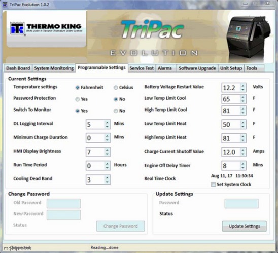

    with any laptop you can use the tripac USB cable and free Thermoking Tripac Evolution Diagnostic tool to set minimum run time and startup threshold voltage, they way you can set it to start when batteries are only 12.7, and if it starts for battery voltage or arctic temp threshold it will run for minimum X time you set, 45 minutes, an hour, two hours...

    see 'run time period' and 'minimum charge duration'
