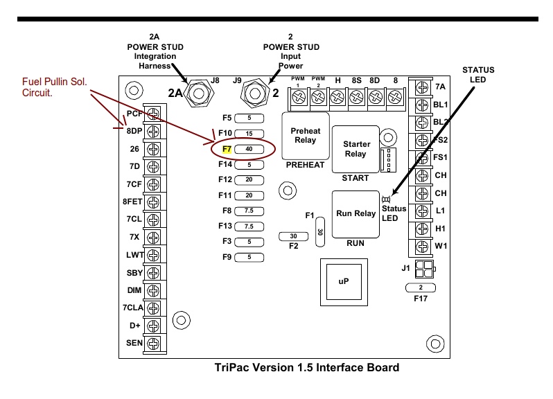

    Need help if anyone has every had this problem with there Thermo King APU. when I turn on my Apu I get an ENG code. I replace the toggle switch in the engine. Checked all fuses everything is good. Resetting ETC breaker didn't thermoking APU .jpeg help still ENG code showing up not sure what to do need help ASAP its winter. Monday I have appointment at thermo king for it but I like fixing things my self.

    Problem was i had a bad computer board. I replaced it and everything good it just needs to be program
