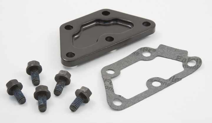

    We sell a cheap factory eaton fuller plate that bolts over the two cooler ports and has the same effect as the looped hose, the benefit is its not sticking out away from the transmission where it's vulnerable to abrasions and a potential oil leaks. If you look where your oil cooler lines connect to the transmission you will see five small threaded holes in the case around the cooler ports this is how the plate fastens to the case

    What year is the truck and what speed tranny auto shift or manual?

    2005. It is an 18spd. I have the coolant to oil type cooler that is mounted on the top of the transmission. There are coolant lines that run in/out on the front side. Those are the coolant lines I was asking about looping or joining for the time being.

    Okay the the kit comes with the five little bolts the plate and gasket and it's fuller number k-2402 and if I remember right it's less than 50 bucks. Well worth it considering it keeps everything factory. Edit. I found it for $10 and some change by Google eaton fuller k-2402
