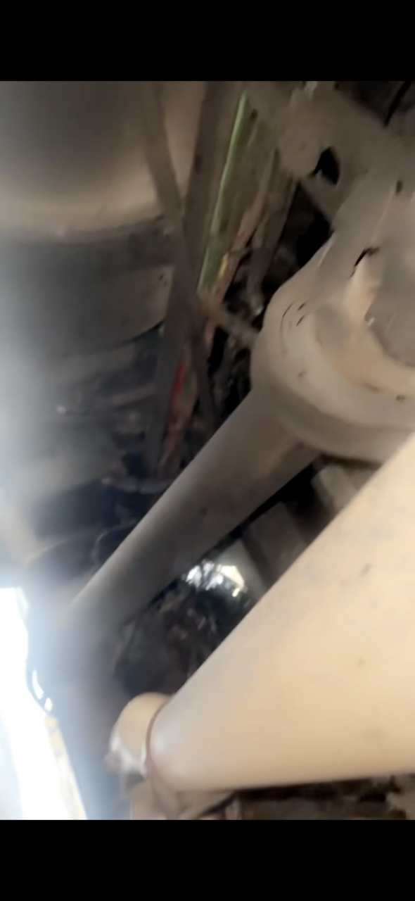

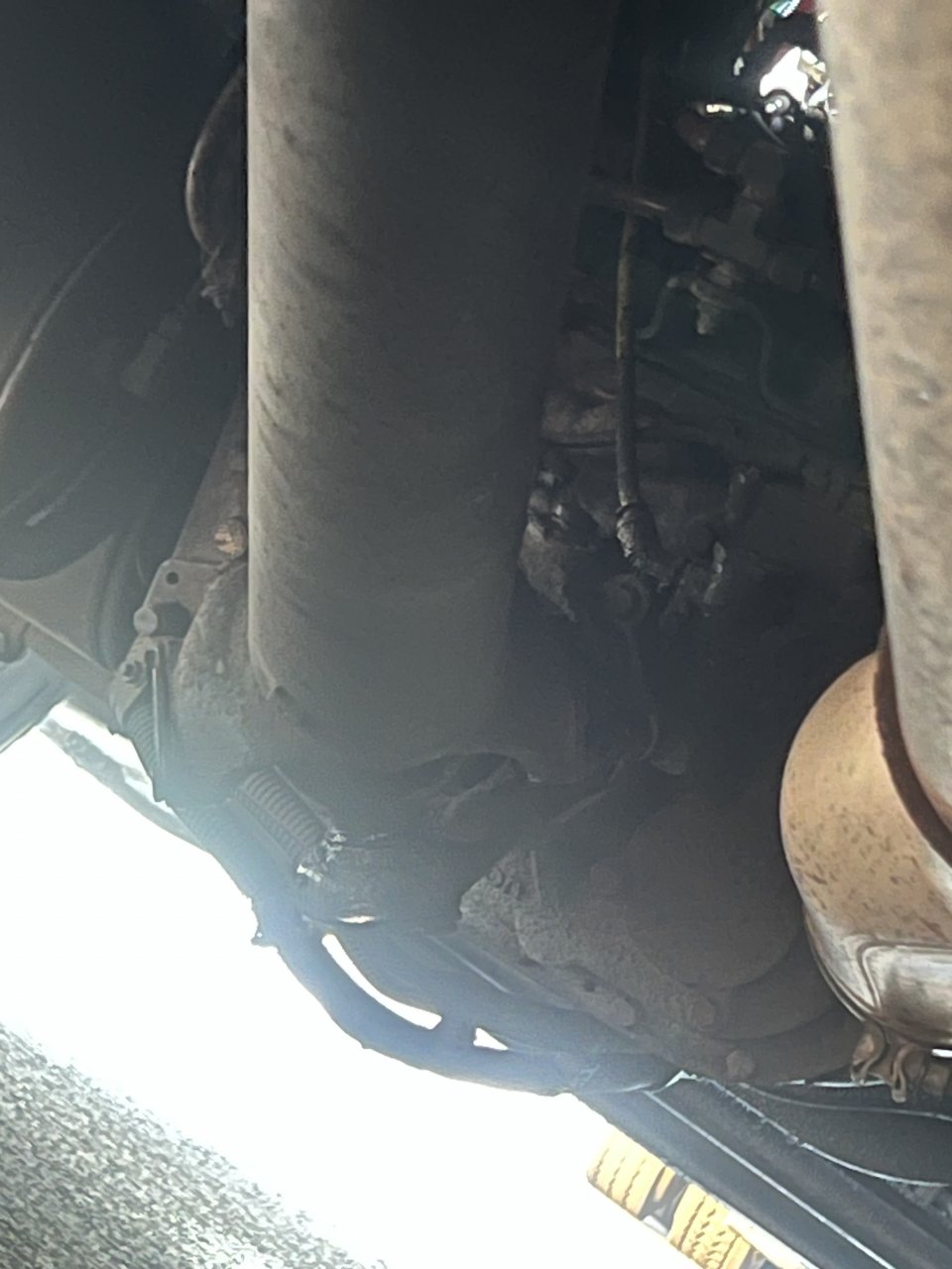

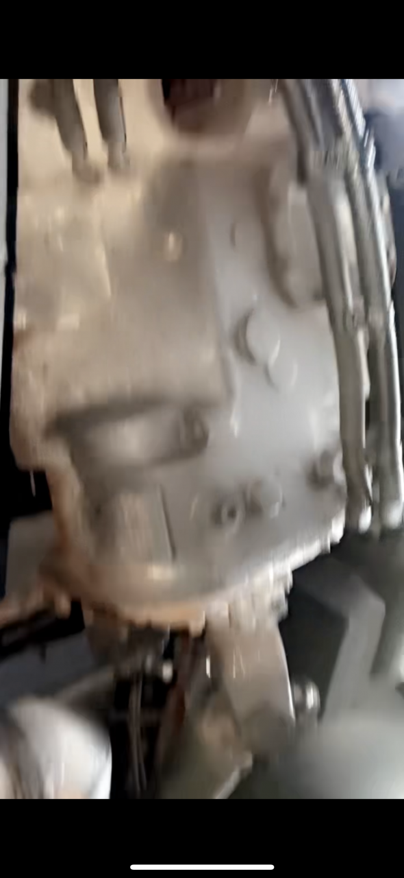

    I have a 2015 freightliner DD15 with automatic transmission. So I was driving and I hear a loud thud and the truck lost all power and I pull over . First I thought i blew a tire but I soon realized my whole transmission and drive shaft were hanging by a thread under my truck . This is a complete mess I’m sure the transmission is completely ruined as all the fluid leaked out.
    My question is how the hell could my whole transmission fall loose ? My theory is back in January I spent close to $10k and got the automatic clutch replaced at the dealer . They must have missed a bolt or didn’t you use any thread locker when the bolted the the transmission back on ? Is freightliner responsible for this damage and do you think they will pay for this ?
