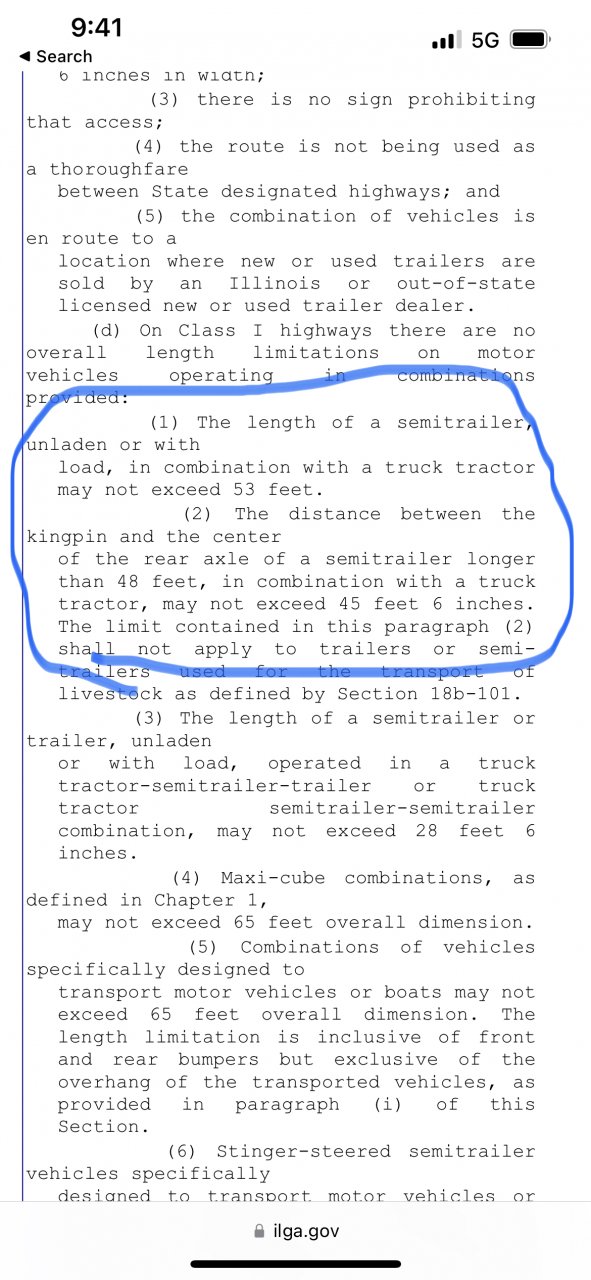

  8. ducnut
    ducnut Road Train Member
    2,429
    7,214
    Dec 31, 2010
    SPI
    IL and IN, respectively.

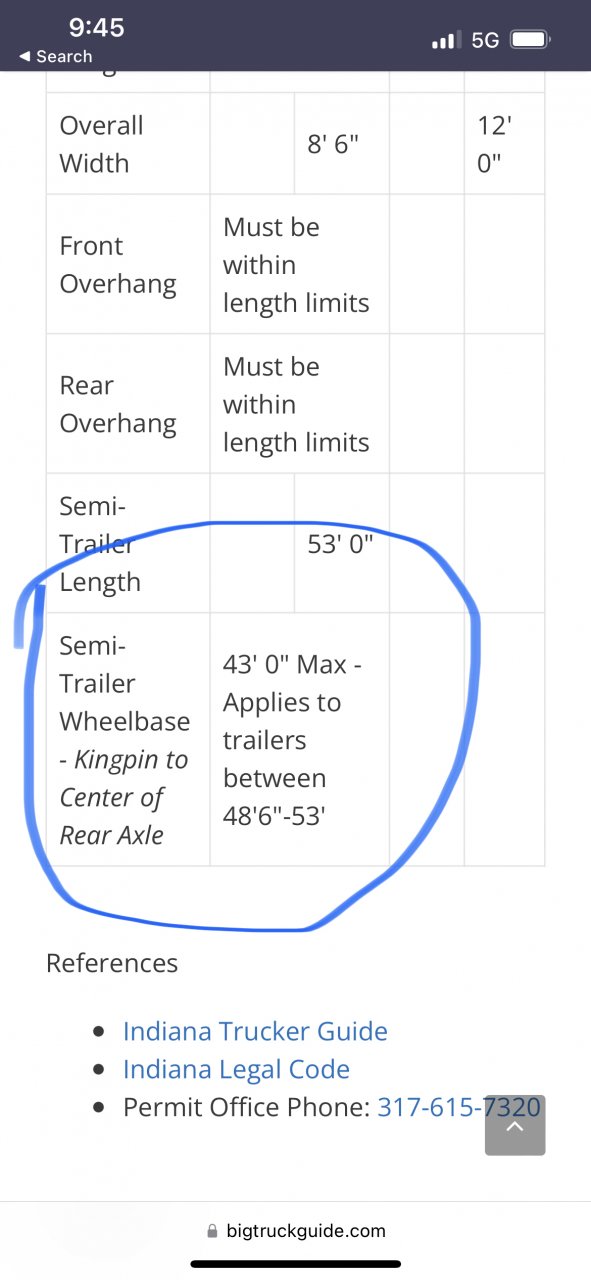

    I keep them on my phone to prove to my 2nd pickup as to why we can’t load 35K pounds in the back-half of a trailer. :rolleyes:

  10. Knightcrawler
    Knightcrawler Road Train Member
    1,236
    4,119
    Apr 10, 2017
    Mpls, Mn oops Ocala, Fl.
    Yes, I know the lengths are different, but I didnt realize that some required the center of the rear axle.
