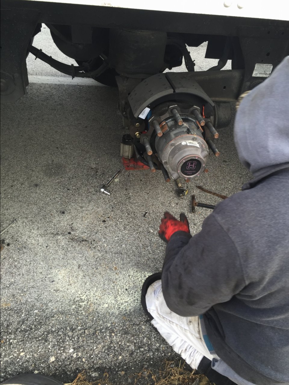

    Had fun today, trotting down the road and I start to see blue smoke coming from the passenger side by the front trailer tire. So at this point im like crap, I lost a cam and tire is smoking.
    So I take the exit pull off and go to look, when I bend down all I see is flames coming off the brake pad of the front passanger side axle. At this point im like :eek: and run my fat arse for the side box to get a extinguisher. Grab it and spend the next 10 min putting the fire out every time it flames back up, ended up using up my main fire extinguisher and my extra on the passenger side.
    Got the fire out finely, now its time to figure out wtf happened. After looking around I found the brake was way to tight in adjustment, I dont know if it self adjusted to tight or if it was over tightened when set. The trailer only has 3k miles on it as I picked it up from Utility new, everything looked fine this morning when I pre-tripped so my guess is it over adjusted.
    Anyways fun day, here is the aftermath.

    My company got lucky on this one, cost was 275$ for a road call and parts. Also two spent extinguishers are getting replaced in morning. Not a bad price to pay to not have the tlr burn to the ground. It pays to watch your mirrors.

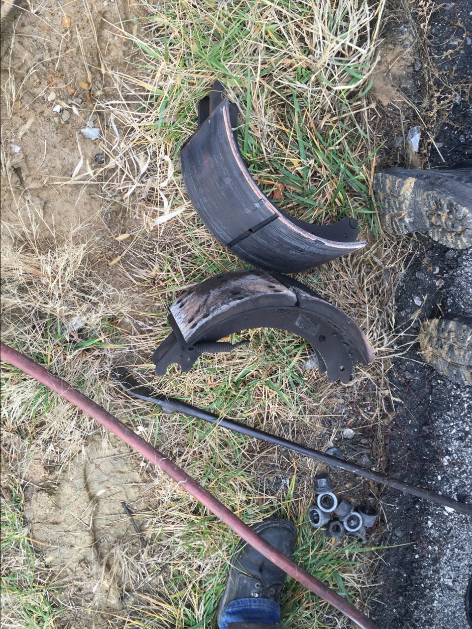

  8. BoxCarKidd
    BoxCarKidd Road Train Member
    4,418
    6,432
    Aug 26, 2014
    Why does one shoe look worn down to the rivets and the other have near new lining?

    Thats how much shoe wore off, that shoe heated the drum and caught the other one on fire. Those shoes only had 3k on them.
