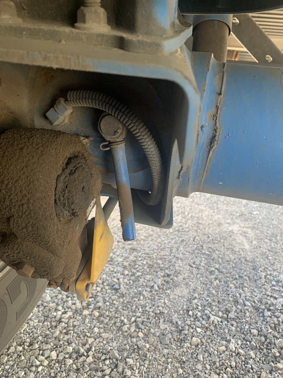

    Found an air leak on the trailer and was curious if anyone could help me out what the issue might be? It’s a Great Dane flatbed with tire inflation system. Air is coming out of the short hose. Thanks fellas!

    The line could be leaking from either side. Cap off one and see if it still leaks. The side that's leaking, pull the hub cap, sometimes the line is just loose. If not, you have to replace the line.

    Swivels where the inside line connects to the hubcaps were the culprit on one of mine. Two were leaking so I put on a set of new ones. those were the ones the trailer came with new, so figured the remaining two weren't far behind. The inside hoses are stainless wrapped and sturdy. Short of a buggered/loose fitting or seized swivel, unlikely in my opinion (but not impossible). I bought a new one just in case, and it's still sitting in my pile of spare parts. If you recently had a leaky hub seal fixed, the quality of the reassembly might be suspect.

    The short hose is just a vent.
    If air is coming out of that then either the swivel (as mentioned) at the inside end of the hub is leaking. Or the line attached to the other side of that fitting with the plastic loom going to the swivel is leaking.
