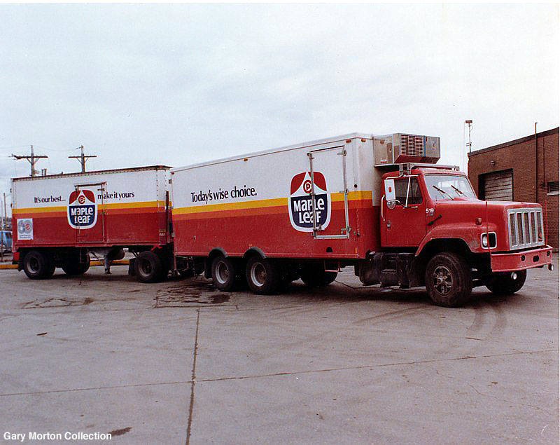

    I used a straight truck version like this setup. But has the air arm and I’m sure reinforcement to pull it.
