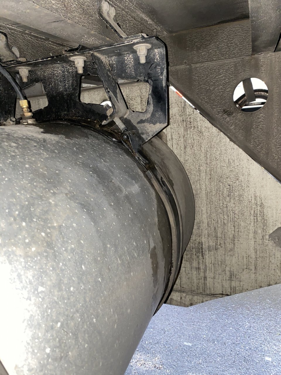

    This is a 50 gal reefer tank. Bolt thread thickness of 12mm or 1/2 inch. Nut size is 19mm. I can’t really tell the material as it has been painted black. I currently have it torqued at 15 ft lbs. I’m noticing these nuts don’t torque very well. Right after torquing it, the nut appears to loosen. I have to torque it several times until it feels like it’s tightening.

    15 seems a little low to me. Do you have a jack taking the weight of the tank? My guess would be 30+

    I have the toque specs on my fuel and hydraulic tanks which is the same setup almost to what you have pictured. I removed both my tanks to do some repairs a few months ago. They are in a position where you can’t get a torque wrench on. Have to use a box wrench . I know this doesn’t answer the question for you, but I just make them good and tight with a little common sense not to over tighten. Don’t want to brake them straps. I think it’s around 30 like the other guy said

    For comparison a Pete 16mm strap stud is 45-70 ft.lbs final torque. Probably a 100 to 120 gallon tank.
    I think 15 is probably on the bottom end of where you wanna be. I wouldnt be afraid to go to 30 or so as mentioned.

    It’s 30ft lbs for aluminum tanks and 8ft lbs for steel tanks.
    Those nuts look like nyloc nuts, they could be worn out, it wouldn’t hurt to replace them if they don’t seem like they’re staying tight.

    You can put a lock washer then a flat nut on top, use a wrench to hold 1st nut in place then tork the top nut down to make where it cant back off?

    My straps were so loose that one of the top rubber paddings was almost falling off. What I should have done is loosed up the entire strap and pry it off the tank, then apply a little bit of grease under the entire strap. While I was tightening it, I heard a snap. My guess is the strap was unsticking from certain areas of the tank.
