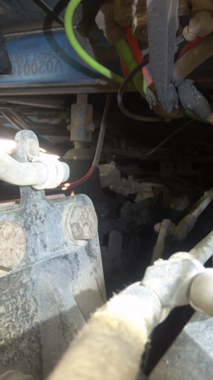

    Dude, buy a pair of cover-alls, put them on. Then wait for truck to cool down. Suck in that gut, and crawl underneath the truck.
    Once under the truck, get into a crouching position, grab a flashlight, and look over the shifter linkage, rear of block and all other stuff under the cab.
    Then decide if you really wanna give up that $1000 (to fix a $40 part)
    stayinback and AModelCat Thank this.
  11. mitmaks
    mitmaks Road Train Member
    2,542
    2,064
    May 16, 2014
    That's what I did. No way Id pay them $1000 to do something like that...
    Its actually pretty tight in there, I can't see top of transmission if Im underneath there as theres no head clearance. Shop said they would have to pull driveline to work on it.
