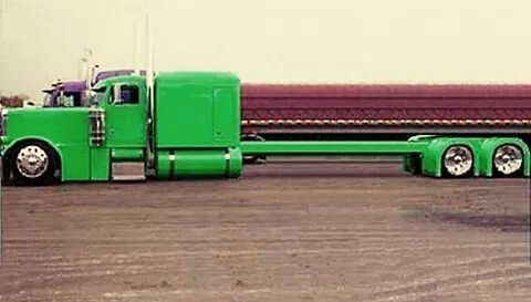

    Maybe you could do like this guy. He's got plenty of room on his frame for Tool boxes.
