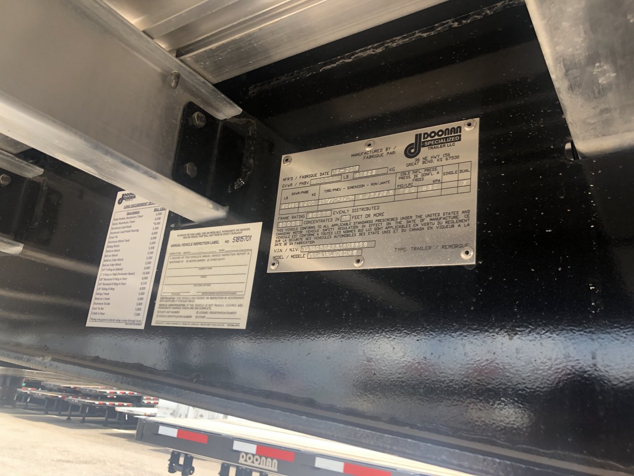

    To be honest I searched thru truck paper ans there is no combo drop deck that they make, that would have 4ft load rating posted. Unless I’m looking at the wrong place. See below. They all have information plaques like this.
    I cannot give up coils. Where should I look for in a trailer spec to have one that can bear 45-50k coil?

    Try getting ahold of the manufacturer. Or even a dealer that will spec a new one. It's possible they consider 10 ft the same as 4 ft. But its also possible they don't build one for single coils. What i know for sure is my great Dane flat has 3 ratings. Beam, 10 ft, and 4 ft.

    Transcraft has it in the model number. Same as benson (all aluminum Transcraft)
    554c model is a combo trailer rated for 55k in 4’
    654 model is 65k in 4’
    724 is 72k 4’
    They make a all steel drop deck that’s 80k in 4’ as well.
    If the rating a manufacturer gives is in 10’ then they don’t have a strong enough build for concentrated weight.
    If you’re hauling predominantly concentrated weight coils of steel; get an aluminum flatbed.
