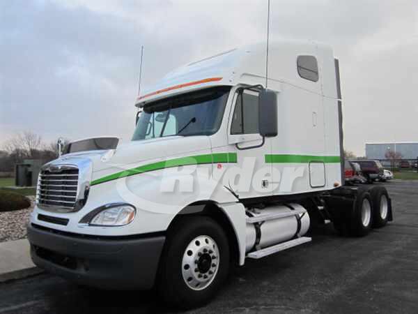

  9. InternationalTrucker
    InternationalTrucker Light Load Member
    70
    19
    Oct 22, 2013
    Dallas,TX
    Engine Make DETR Engine Model 14L'04 455/1800
    HP 455 Trans. Mnfg FULL
    Trans. Model RTO-16910B-DM2 Trans. Type Auto Shift
    Trans. Speeds 10 Suspension Type AIR RIDE
    Color WHITE Sleeper Size 70
    Sleeper Type Condo Gear Ratio 3.42
    Wheel Base 226 JakeBrake Yes
    Mileage 665624
    here is some pics:
