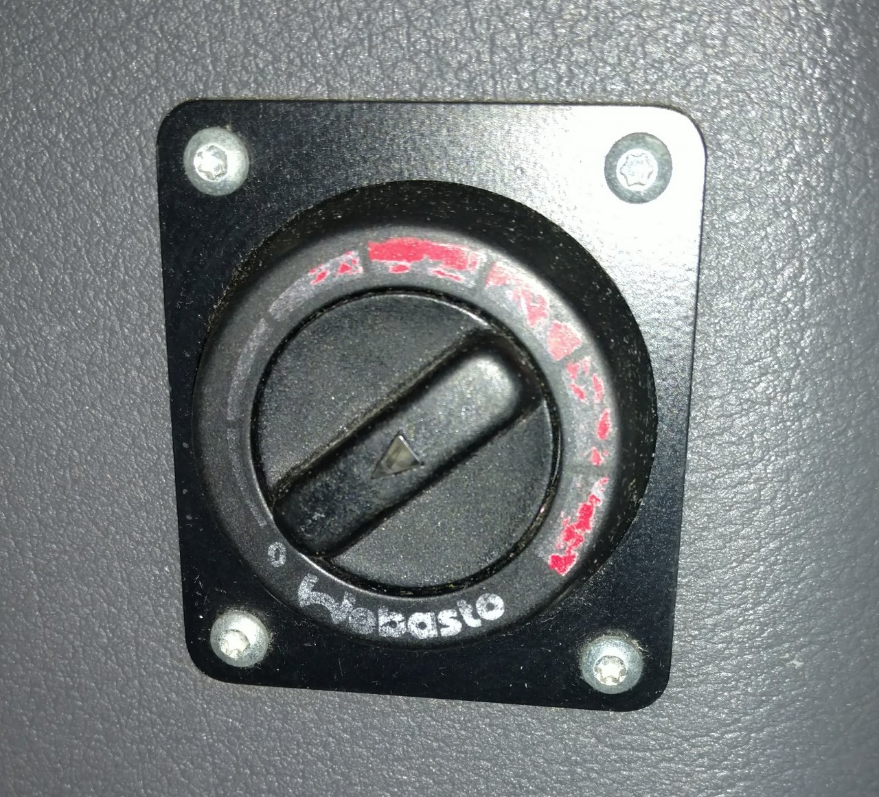

    Does it look like this?
    Look for this:
    In the early split systems the TK control panel only controls the a/c and fan speeds. Heat control is strictly done through the Webasto rotary dial (or optional digital). The dial sets the temp only. The fan speed is set automatically and depends on the spread between ambient and set temps.
    The heat should only run with the key in the off or acc positions.
    TA

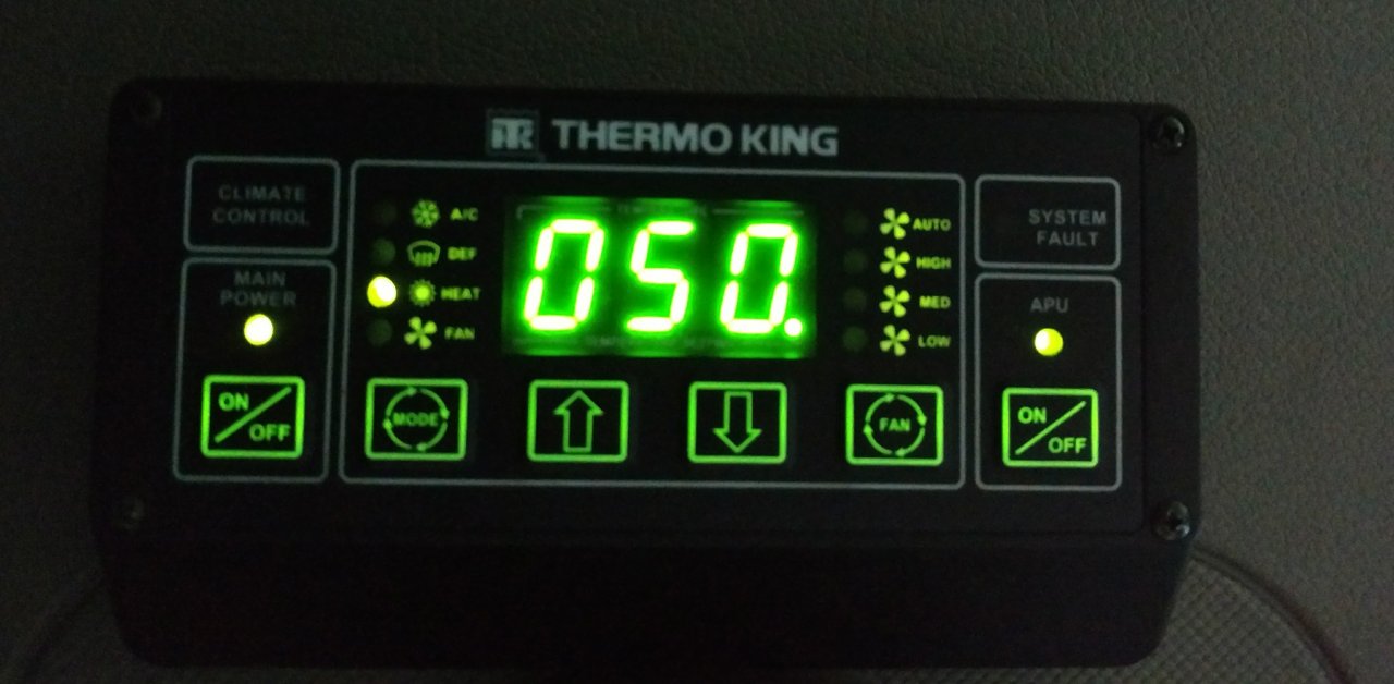

    Nov 19, 2012
    IMG_2281.JPG This is my controller
