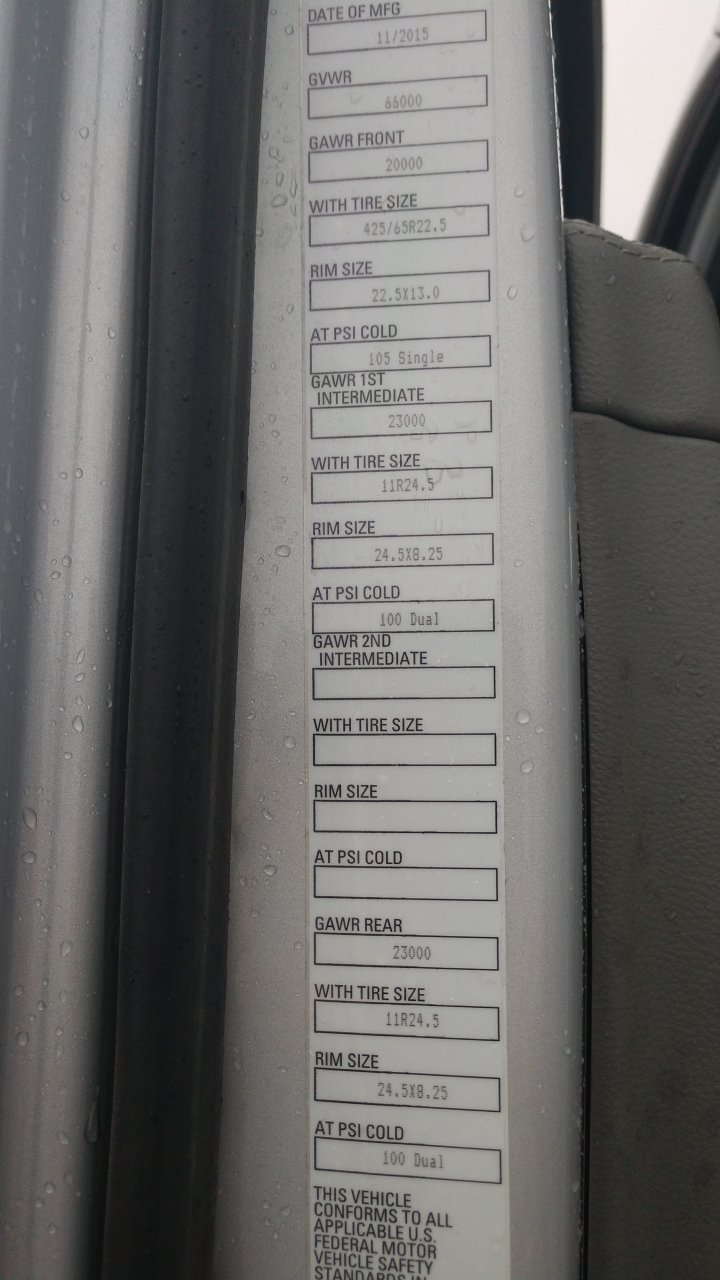

    You can only run up to the rating on your steer axle. Most trucks have either 12,000 or 13,200 steer axle ratings. You can find out what your truck has by looking for a sticker on the driver's door jamb that looks like this:
    You can only run up to 20,000 lbs if you have the correct axle/wheels/tires for it.

    Alright, where can I see what the axle/wheels/tires are rated at?
    I believe the trailer is a closed tandem.
    The trailer tires are set to the rear of the trailer.
    So, if I understand correctly, if everything is good with the steers (correct axles/wheels/tires), the only thing that needs to change is the trailer/drive.

    You can find the tire ratings on the sidewall or look up the tire maker's load/inflation tables.
    Like others said & showed, hopefully you'll have a sticker or tag in the door telling the axle rating. Also, the right mechanic might be able to look that up from the truck's VIN.
