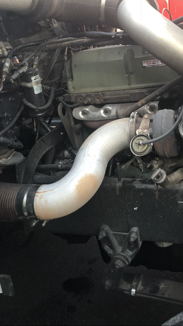

  11. Rideandrepair
    17,201
    55,791
    Aug 8, 2015
    D2C420E8-0655-427A-A89E-B67D4510A3FC.png New s pipe, no more broken flex pipes. Less movement. Note clamp
