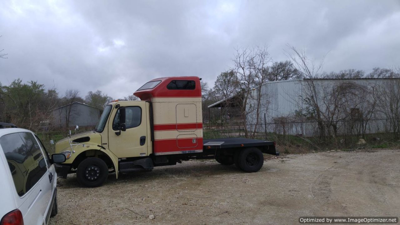

    I wouldn't do a sportchassis it's cool and all but it can't do an 18 wheeler job and a pickup can do a 5-car more efficiently. If you're gonna do a 5-car get a 5500, repair/maintenance would be much less expensive than a sportchassis.

    That's a cool looking franken-truck! I'd drive it all day.

    A 5500 is perfect for a 5-car trailer such as Kaufman Mini5, don't worry too much about the gcwr no one is paying attention to it. A sportchassis is certainly more heavy duty than a 5500 being it has air brakes and even air ride I think, it is equipped with either a Caterpillar engine or Mercedes MBE series. My franken-truck has 23,000 lbs gvwr I think but it was a straight truck I'm not sure if a gcwr can be found for it.
