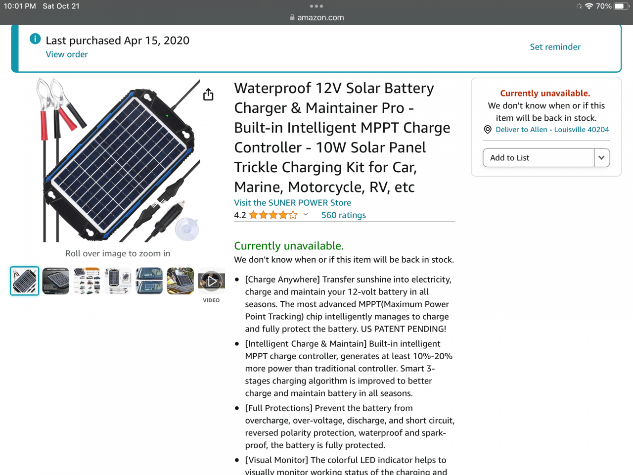

    i got a low battery warning on my vw taos after not driving it for 2-3 weeks so i bought a 10w solar trickle charger that does the job on a car but this topic is for the truck

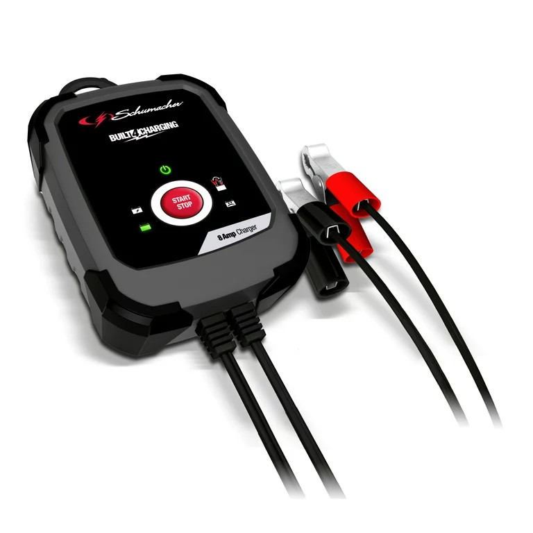

    What is the amperage rating of the charger? Based on the 50W rating that you stated that is only a 0.5A charger.
    If that is the case may I suggest using a 1.0A-2.0A smart trickle charger to maintain your batteries.
    This is the one I use...
    Robot or human?
    This is an 8A smart charger that will charge at 8A when connected to a weak battery bank but once the voltage and amperage have been brought up the charge rate will come down to whatever is required to maintain the batteries.

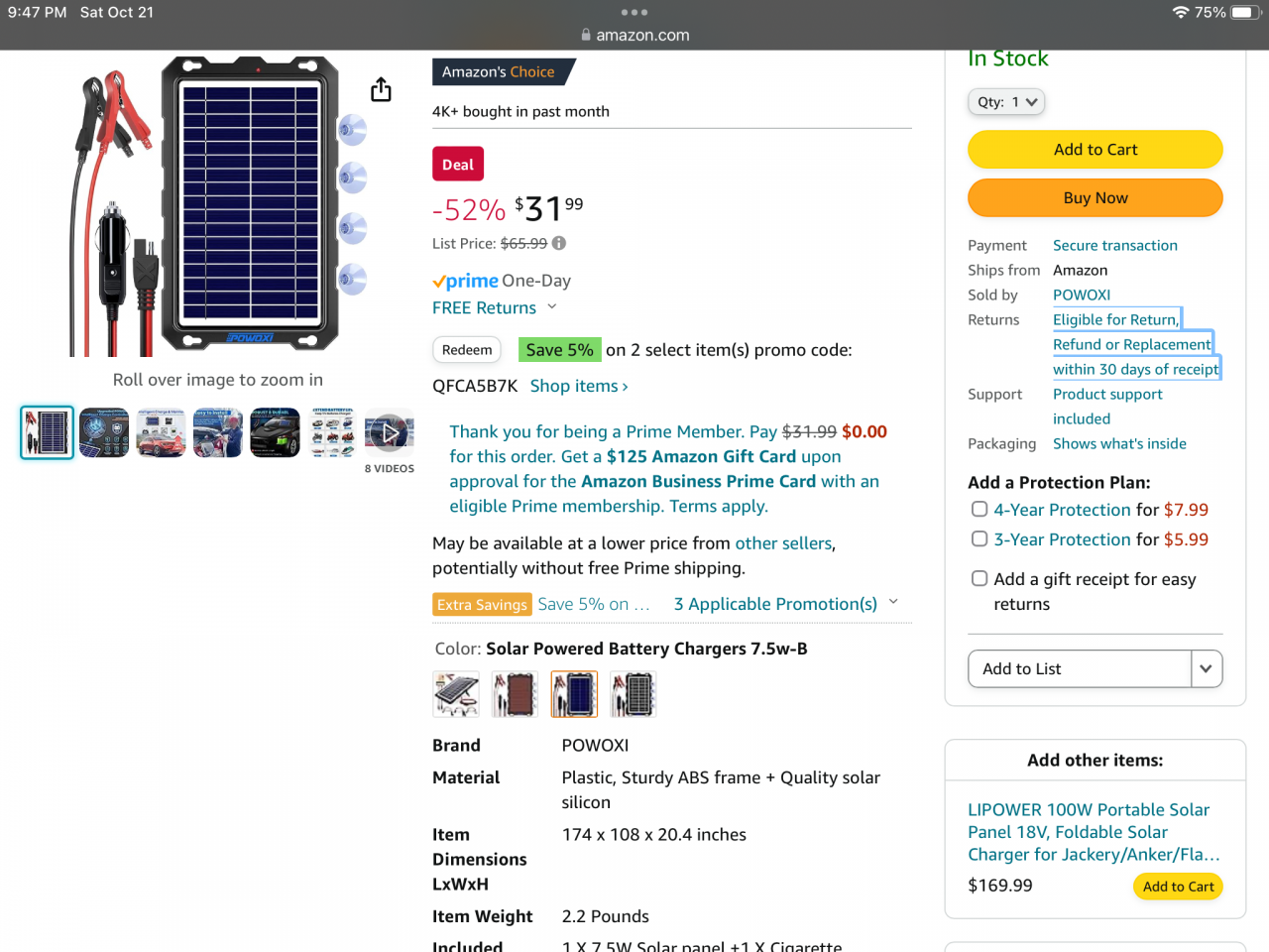

    It worked with only 7.5w thats awesome
