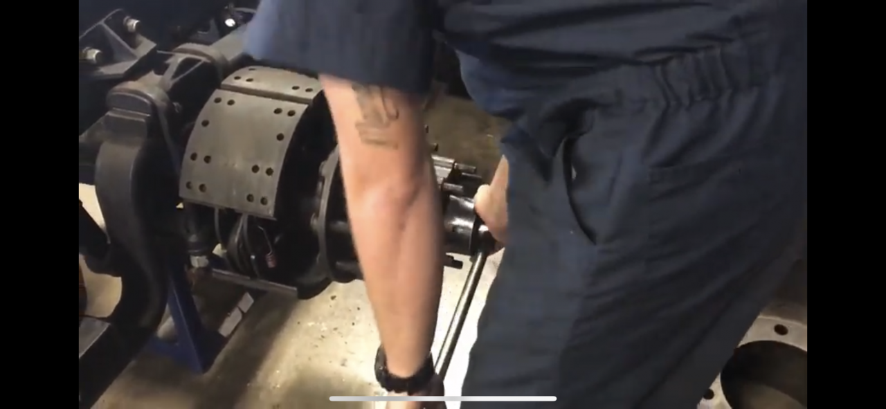

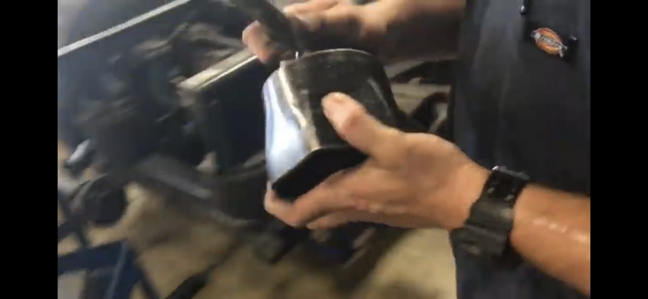

    On a 2014 Freightliner Cascadia DD15, what socket or tool do I use to remove the nuts holding the axle bearings? I’ve watched some videos where they use some weird socket meant for this very purpose. What’s the name and the size that I need?
