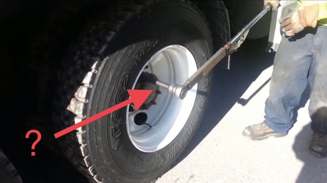

    I have a 2014 Freightliner Cascadia and a 2019 Utility trailer. I hear it’s 33 mm. Would that be true for both truck and trailer? I also notice my trailer may need a long socket. Am I right about that?

    Yep- If you dont have a 33.. 1 5/16 will work- But dont get too comfortable with it.
    As for the Long studs.....You should be good with a Deep 33.

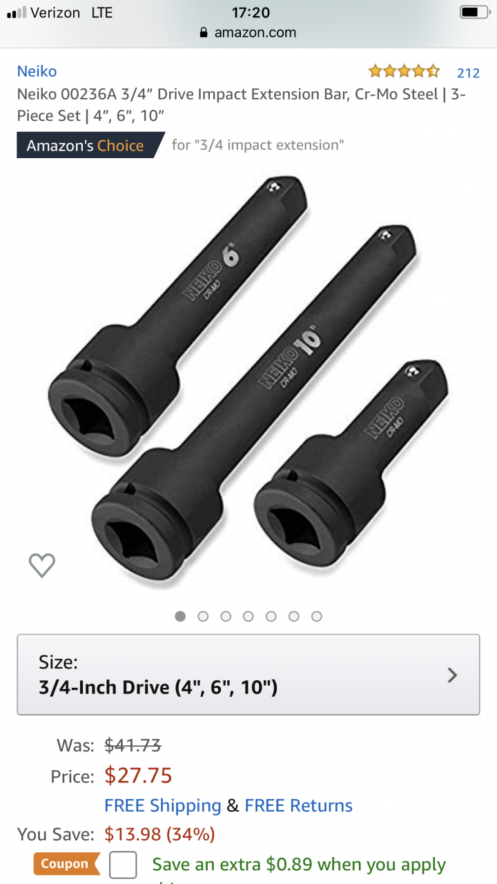

    Do you guys use a 9+ inch socket extension bar with the torque wrench for lug nuts other than the steer axle?
    Ok, I found the answer. They have them on Amazon. The 10-inch appears to do the trick.

    Like he said, the 1 5/16 is the same as 33 mm, but it is available anywhere tire sockets are sold.
    If you have steel wheels you will need the long one. You can also get by with a shorter extension, in fact the shortest one you can use is the easiest.
