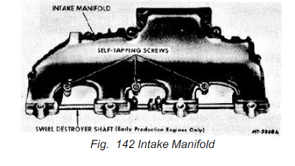

    I think the truck has an old 550 V8. These engines (if still original) idle and run low loads on 4 cilinders.
    Early engines had the swirl destroyer.
    The swirl destroyer knob and cable operated butterfly/throttle valves in 4 of the intake ports.
    These valves were to be operated on cold engine to aid starting and warm-up at low loads closing the intake ports on the cilinders that were not firing.
    Picture from engine manual:
    It was not uncommon to have the fuel pumps modified so the engine ran on all 8 all the time. In that case the swirl destroyer was not to be used.
    I've never seen it, but I heard stories of the butterfly valves breaking of or coming loose and being swallowed by the engine. Not a good thing of course.
