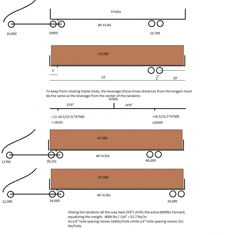

    It is a standard statics problem. For an evenly distributed trailer:
    Cliffs:
    6" hole spacing 316 lbs/hole
    4" hole spacing 211 lbs/hole
    (Assuming you're close to 80,000 gross and the load is fairly evenly distributed)
