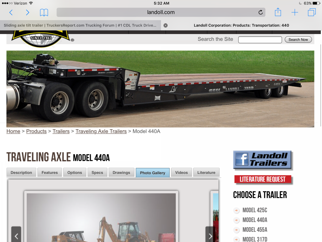

    Looked like this....

    Yea, I don't get what he is talking about. The transition is relatively small when spread over 40'
