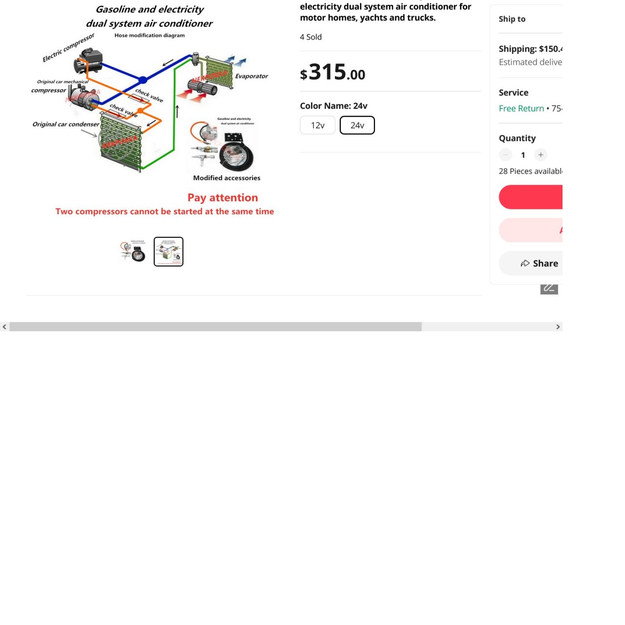

    dual ac.jpg Looking online, I found this kit from aliexpress. Shows dual compressors in a mobile application.

  10. AModelCat
    28,848
    154,281
    Don't know how well that'll work. A/C conpressor normally takes around 5-10 hp from the engine to run. If my math is right and assuming a 5 hp draw that's 3,730 watts. You would realistically need about 35 amps at 120 volts from your generator. Not going to achieve that from a 120 volt outlet.
    If the electric compressor motor is 220 volt, you'll need roughly half the amperage required at 120 volt, so about 20 amps. That's more realistic.
    Snailexpress and Deezl Smoke Thank this.
  11. Deezl Smoke
    Deezl Smoke Medium Load Member
    458
    288
    Feb 12, 2011
    Hillsboro Oregon
    . What about installing a "soft start" chip, even on a 220? Is'nt it usually the start up spike that causes the issues?
    I did see a couple companies offering higher voltage motorized compressors.
