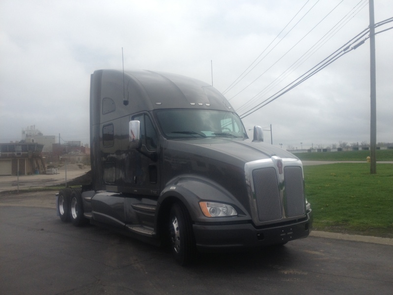

    How about a picture of the new truck.
    Here's a few when I picked it up.
    I really like how I can pull up the digital gauges on the KW NavPlus.
