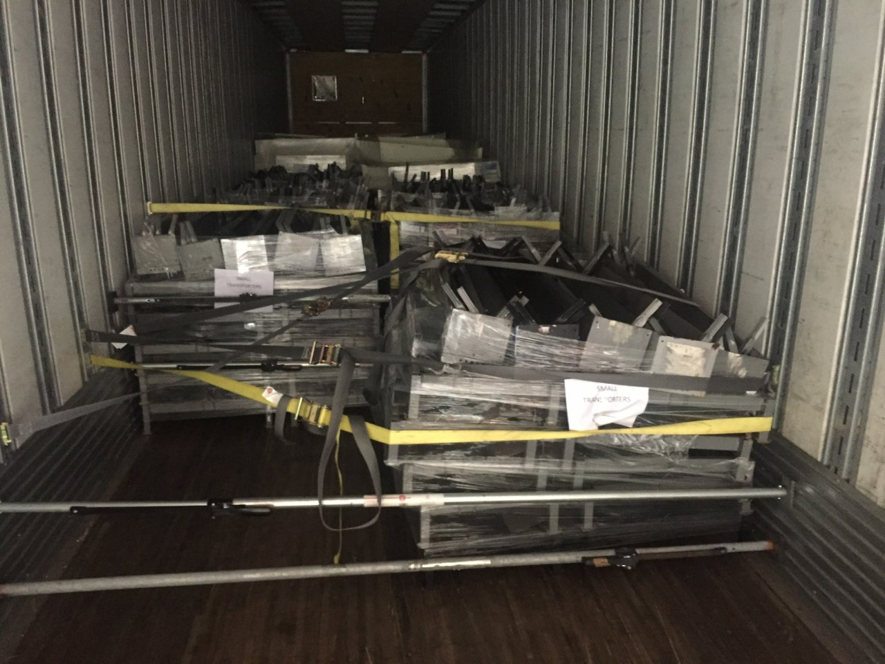

  7. Judge
    12,858
    84,414
    Not always, sometimes not even palletized, just junk everywhere
    I had straps and load bars all through this load of shelves and racks.
    One wrap around of plastic, they didnt want to contribute to the filling of landfills
    Took a photo to make sure they didnt say it was all over the place when I got to reciever.

    On loads requiring more than 2 straps there's usually a securement fee add on $100 or more. 20191216_164234.jpg

  11. 201
    201 Road Train Member
    12,047
    24,587
    Apr 16, 2014
    high plains colorado
    Well, 1st of all, that looks like a s#*% load to begin with, I'm talking most of what gets shipped in a box, that I've hauled, were 20 or so wrapped pallets, one ( or 2) square e-trac bars on the back, sign ze papers, later and I hauled a lot.. Freight haulers will get loads like that, and the drums, one square load bar is all I ever put on those loads, and they never moved. Of course, I didn't drive like Parnelli Jones, either
